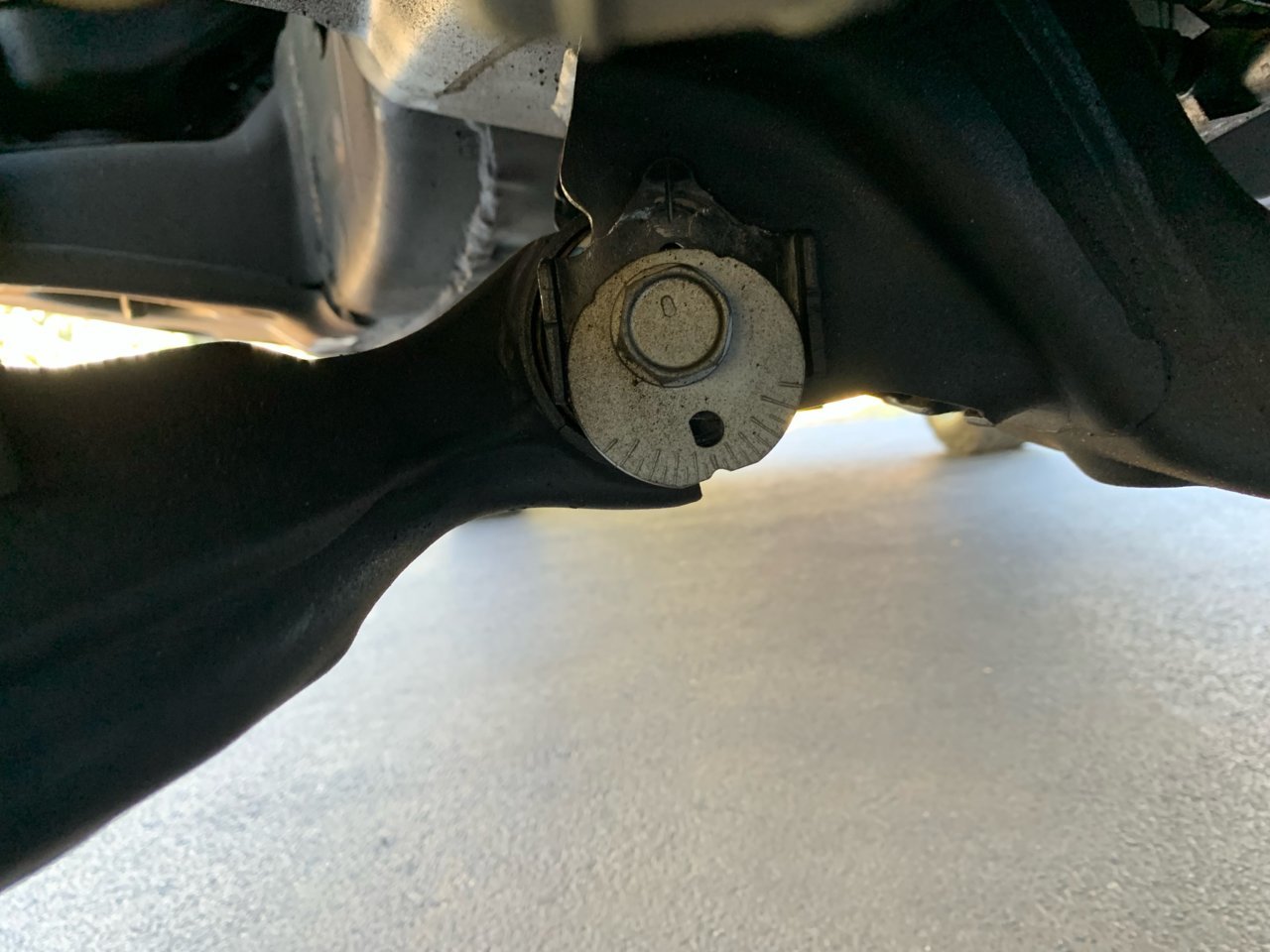

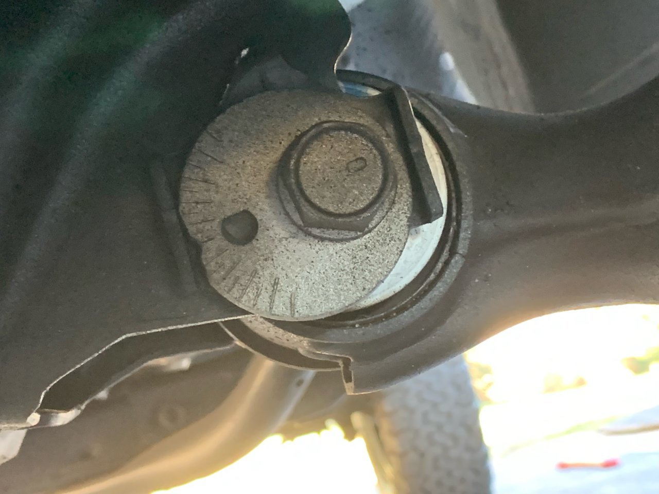

    D64DA5CD-4515-4AF1-9B88-3D55F18F4030.jpg 16CFD56A-8744-46EA-A1DE-9A4847D038C6.jpg He had moved the indexing plate on the PS only. The DS is at D don't know what the PS is but think its at E.

    Make sure they moved the SPC index plates the correct direction, your picture makes it look like your wheels are really far back in the wheel well.

    I think he moved the PS to E ?
