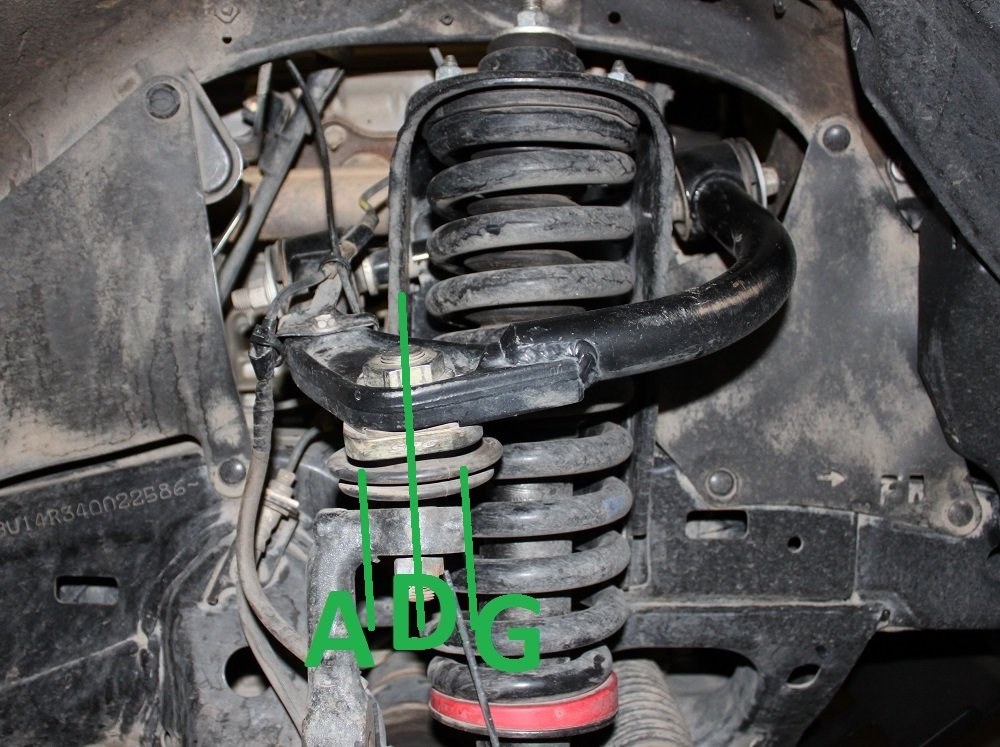

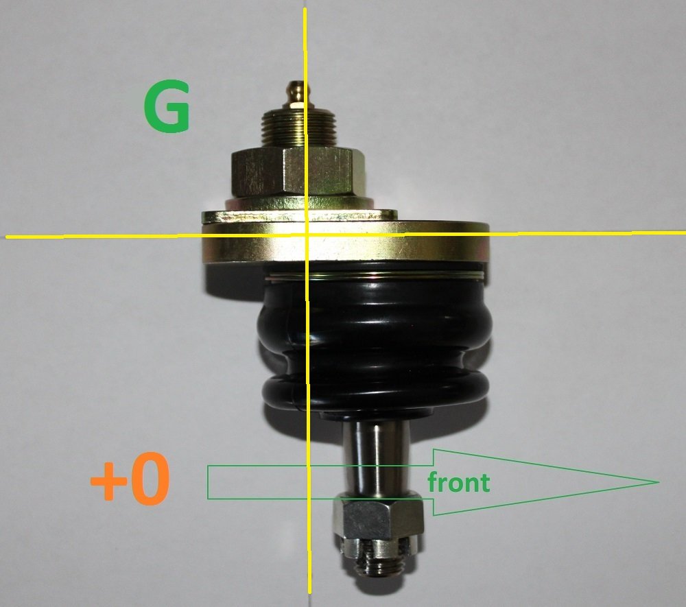

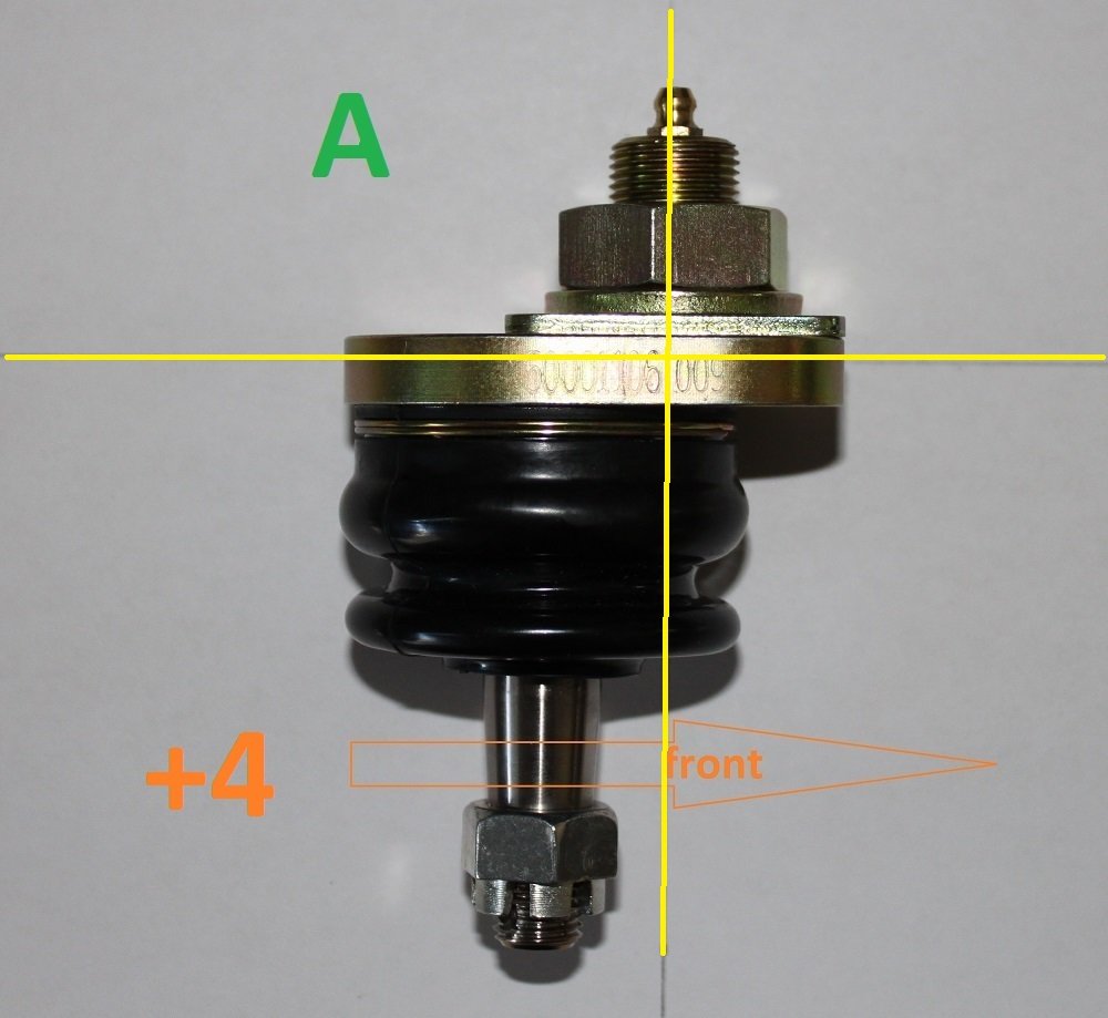

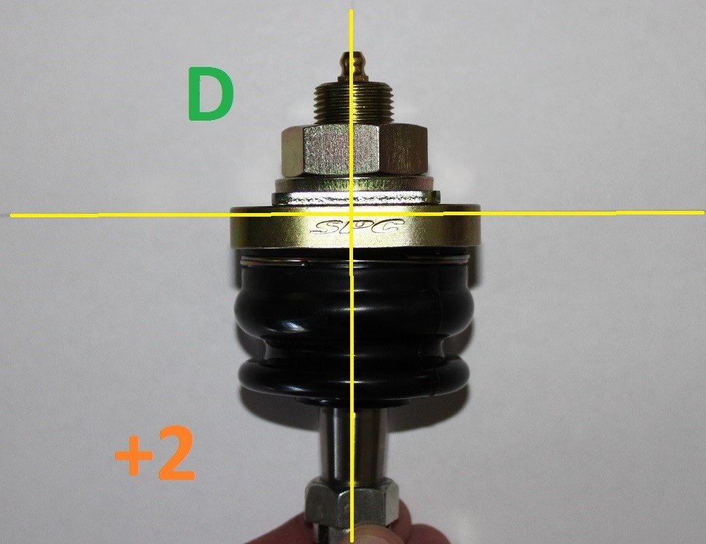

    BackOff
    BackOff Well-Known Member
    Jun 19, 2018
    #256888
    310
    Derek
    The corner of Idiocracy and the Twilight Zone
    2004 SR5 4Runner V6 4x4
    Noise mods/Weight Mods
    Caster SPC

    I've had the SPCs, Icon Delta Joints, and JBA ucas. The SPCs do in fact allow for more fine tuning in getting your tires away from the back of the wheel well as long as you are not looking for big positive caster numbers.
    "D" position will give you +2 degrees of caster over stock.
    "E" position will give you +1 degree over stock.
    By utilizing the "E" setting and maxing out your lower control arms to max positive caster while adjusting your camber at the UCA you will get good caster numbers and keep your tires further away from the back of the wheel well. Just make sure you cycle your suspension afterwards to make sure the UCA ball joint does not make contact with the coils.

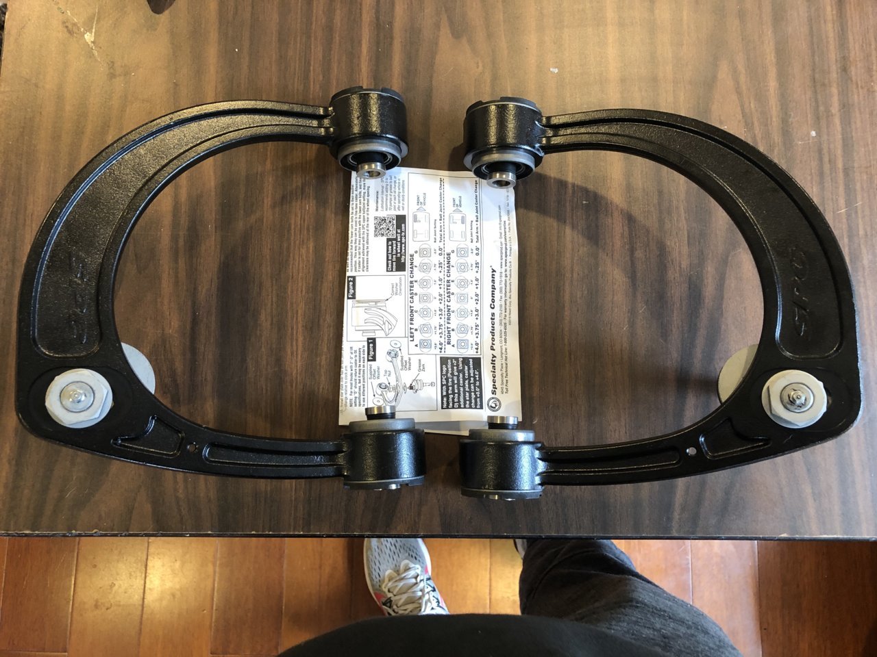

    Getting ready to Install these this weekend. Does this look correct for setting E? I placed the control arms like they would be on the vehicle with the instructions in the middle just want to confirm.
    CBrob likes this.
  16. Apr 3, 2020 at 3:47 PM
    #36
    TVH475
    TVH475 Well-Known Member
    Dec 18, 2018
    #276220
    325
    Montrose CO
    That's how I run mine
