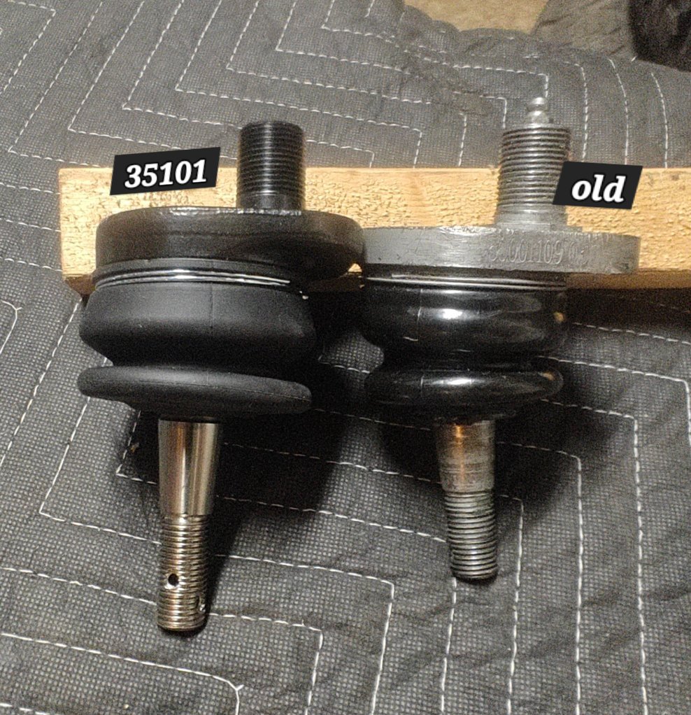

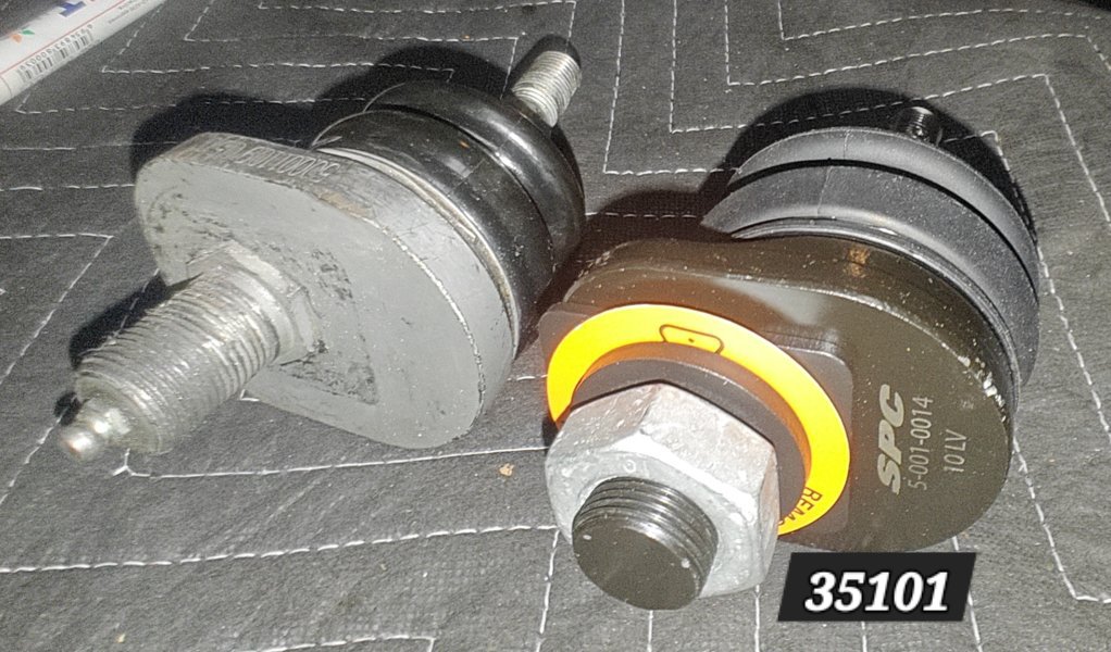

    35101 bjs were released in June 2024 and many companies were still selling the old style. Post pics

    Here are pics of new bj part 35101.

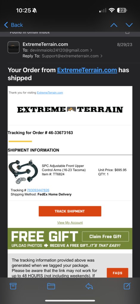

    2023
  12. Jun 22, 2025 at 9:44 PM

  13. Jun 23, 2025 at 4:59 AM
    D Mayo
    D Mayo [OP] Active Member
    Jun 19, 2025
    #473019
    40
    Devin
    2021 Toyota Tacoma Off Road
    2” level with TRD lift kit. SPC UCA. 285/70/17 OME medium load leaf
    It’s there

    So two years old? That aligns with the ball joint life reported by some folks here.
