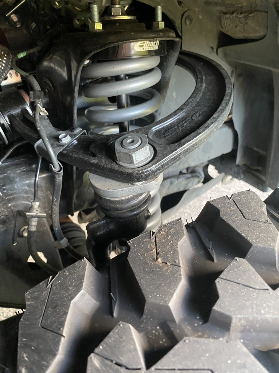

    Is this a bad setting to be at? Appears to be position B maybe. Alignment shop set it up. I asked for around 3 degree caster but never saw a spec sheet after or anything.
