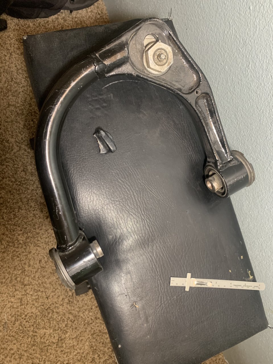

    Was talking to my buddy about doing a 2.5-3 inch lift on my 05’ Tacoma, he pulled these out of his garage and said I could just have them since he no longer has a Tacoma. I was looking at JBA or camburg. These are called “SPC”. I can’t find a lot of reviews on them, but will they function just as well as the other brands I am looking at? 681C3637-EEE7-4ED3-A62E-D34B91F552F5.jpg BD9170CD-560F-40DB-A4A1-3FFD26B822AE.jpg681C3637-EEE7-4ED3-A62E-D34B91F552F5.jpg

    Great arms they will work awesome lots of adjustability. Pretty popular control arms to should be a lot on here about them.

    Have and like them, I’d get some new bushings and ball joints it’ll be good a new.

    Grease the ball joints at least. Find out how many miles he put on them.

    Id just grease the ball joint and throw them on then. Unless the bushings are dried out and stuff. They look new nice score

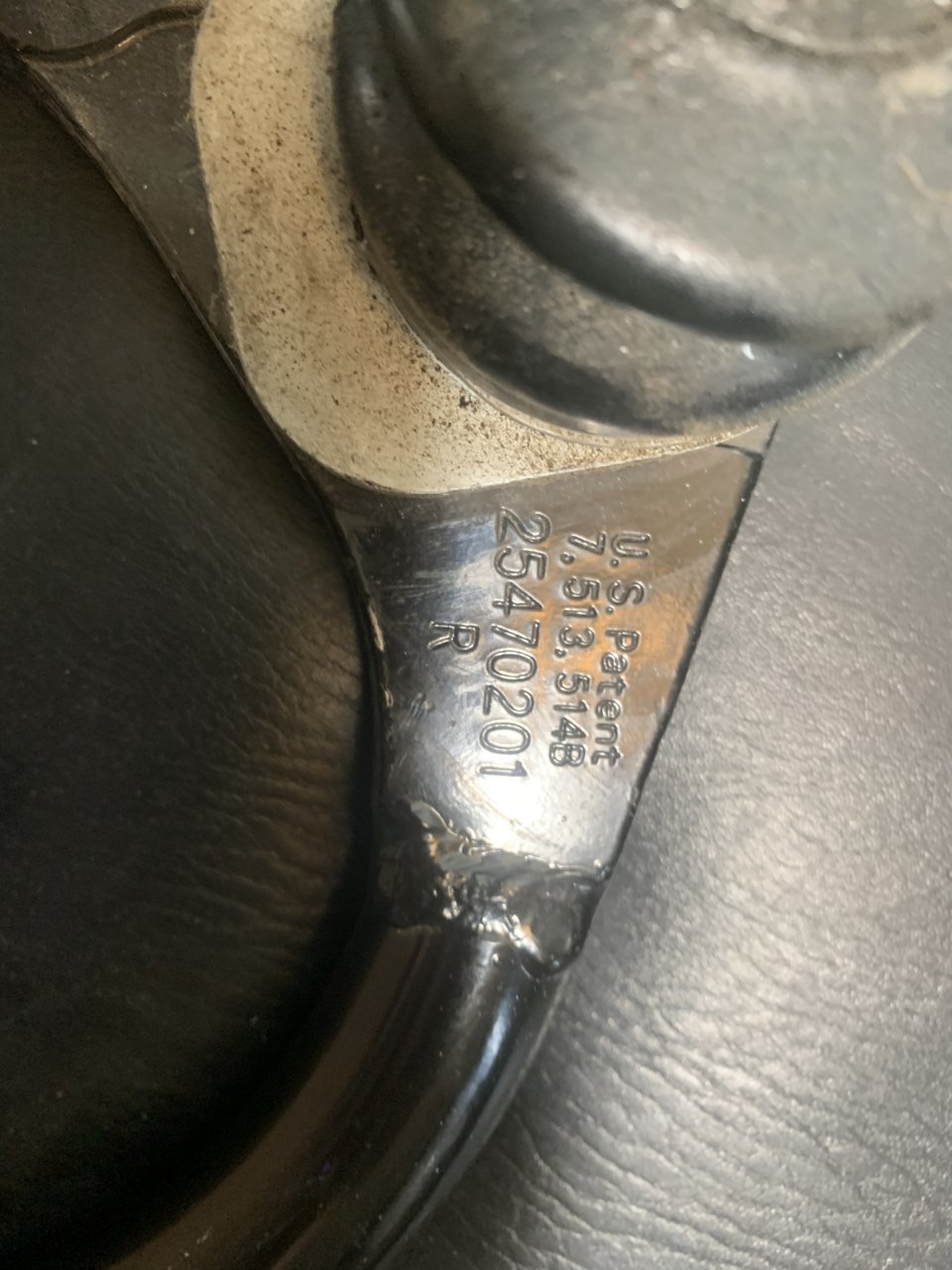

    These are the older ones. The new SPC UCA doesnt have those welds in them anymore. I'd sell'em & put some money towards a new set.

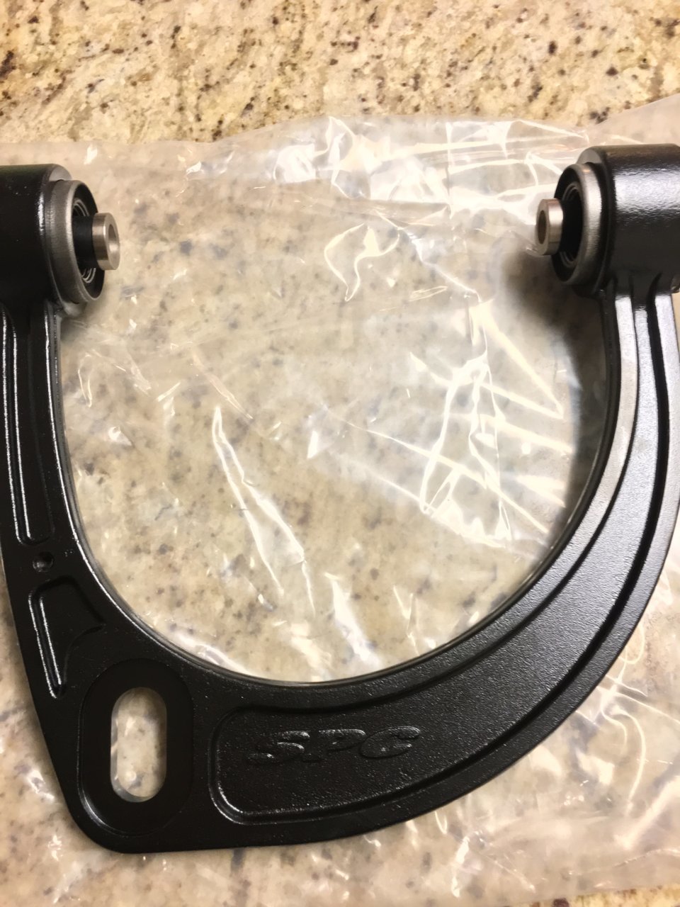

    These are the new ones. You can see the welds are missing. Got a great deal on these from Showstoppers USA last Labor Day!

    I like my spcs, also they have a upgrade program right now, it’s $200 out of pocket once you mail yours back. New models are much improved.

    New ones have improved bushings that are “maintenance free” and they are forged. My old style ucas are squeaky AF only way to correct is back out the bolt and pump some grease in. I spent the $200 and upgraded to the new ones.
