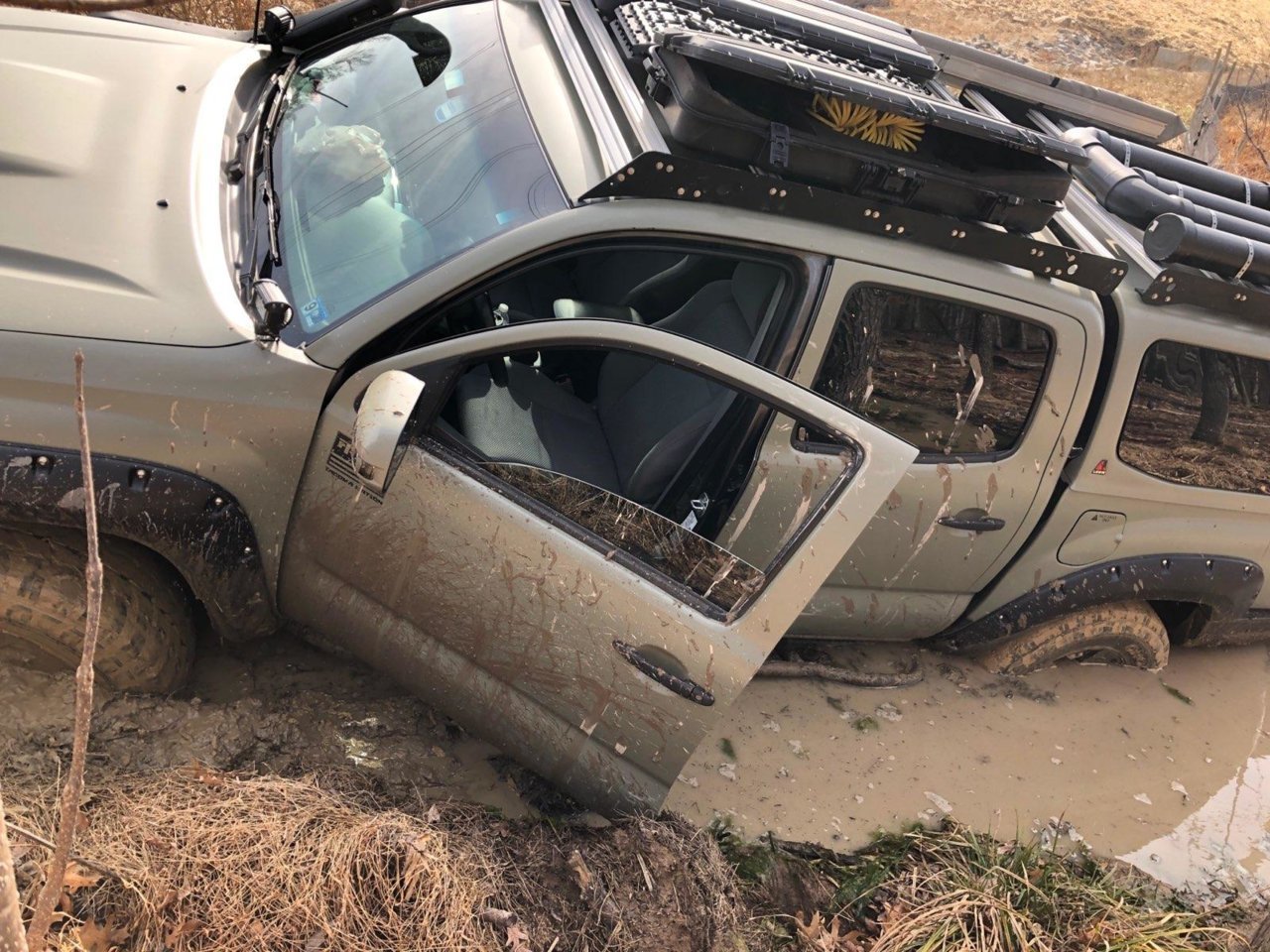

    These are the arms i run and they're great, plus you can use the adjustability to move the tire slightly forward in the wheel well. Been all over with them and had 0 issues.

    HOLY CRAP!

    Yeeaaaahhh.... poor truck has had a hard life.

    If only we could say the same about the rest of your poor truck.
