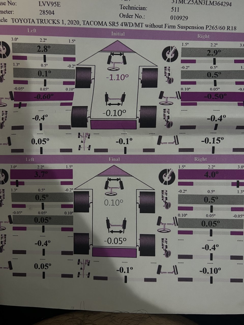

    Wanted to check in to see people settings, I did mine about a year
    ago
    For my set up, I have a 2020 SR5 4 x 4
    Billstein 6112 2.5 lift
    Billstein 5160 add a leaf and overload
    285 75 16 on stock wheels with a 1 inch bora spacer
    for the SPC control arms I have it at setting c (SPC logo, facing the tire)
    And for the camber adjustment, bolt maxed towards the tire
    I was able to get 3.7 castor on the left side and 4 castor on the right.
    absolutely no rubbing on road off-road, full lock
    My question is, when do you fill zert fitting? Does anyone else get grease coming out of boot?
