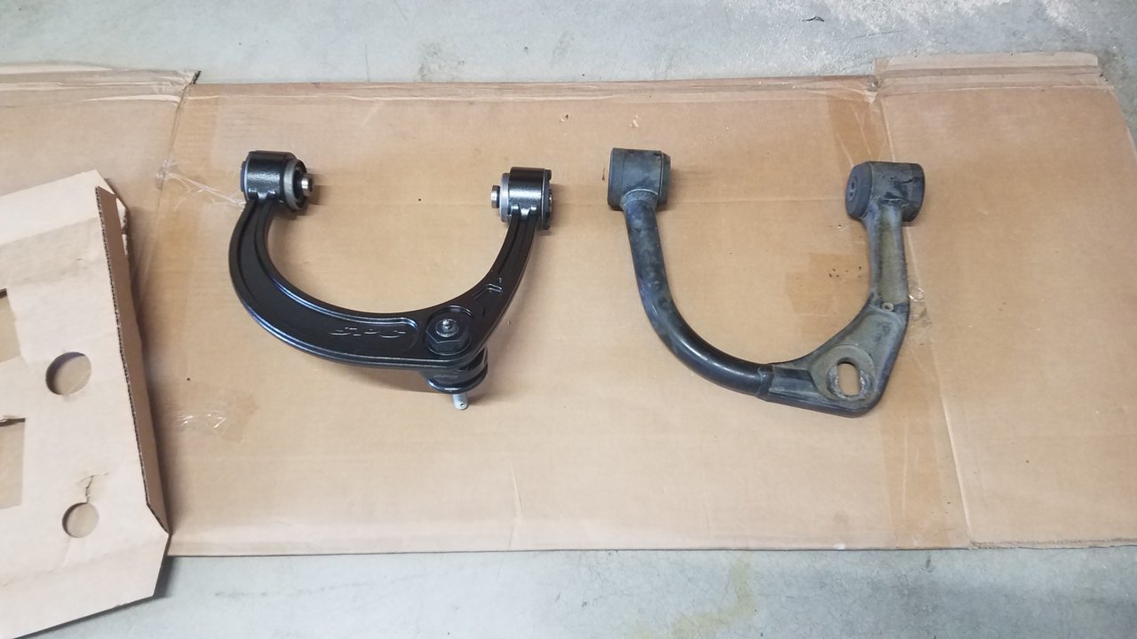

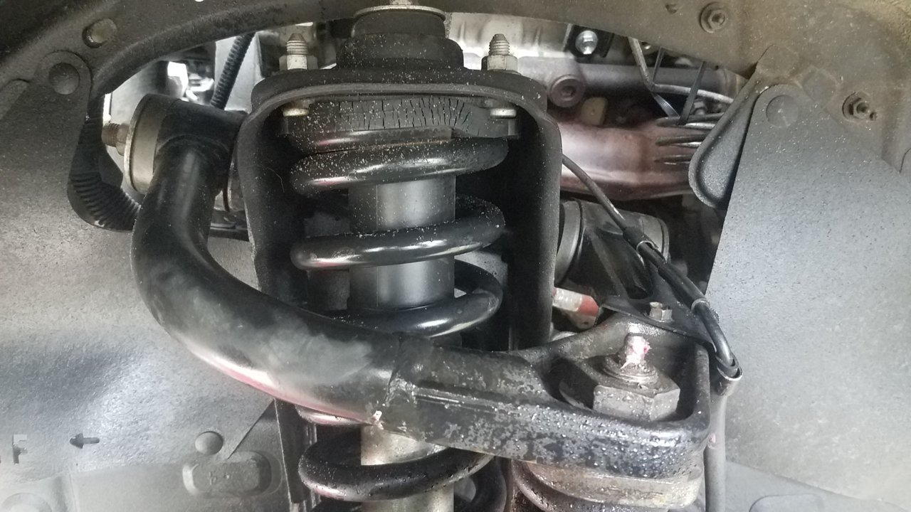

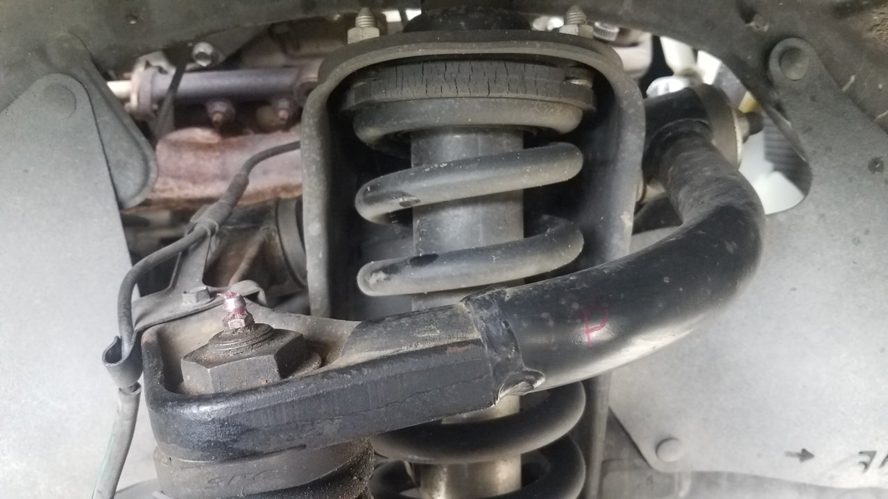

    UPDATE: I recieved and installed the new style spc arms and shipped the old ones back to them. I recieved my credit of $430 making the new arms a $200 upgrade! Looking at the old ones I believe there was some binding in the bushing due to using the wrong metal washers. My frontend was always fairly jarring over bumps that I thought was due to the 5100s, but these new arms have bushings that pivot differently than traditional bushings and it makes a noticeable difference in ride quality. As for the swapout program with spc I just emailed them with pictures and they asked when I bought them. I told them around 2014-15 since I couldnt remember when exactly and the guy I emailed said I qualified. Not sure on the specifics other than that.

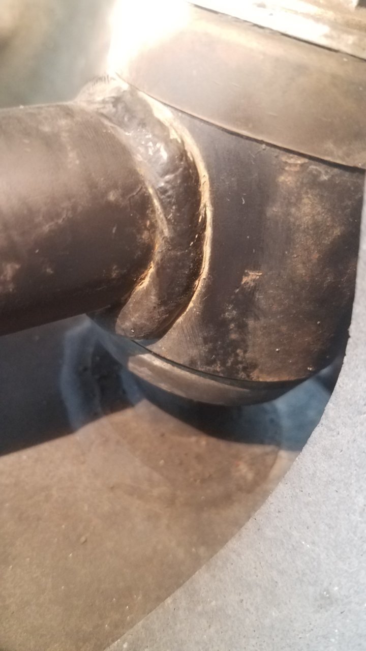

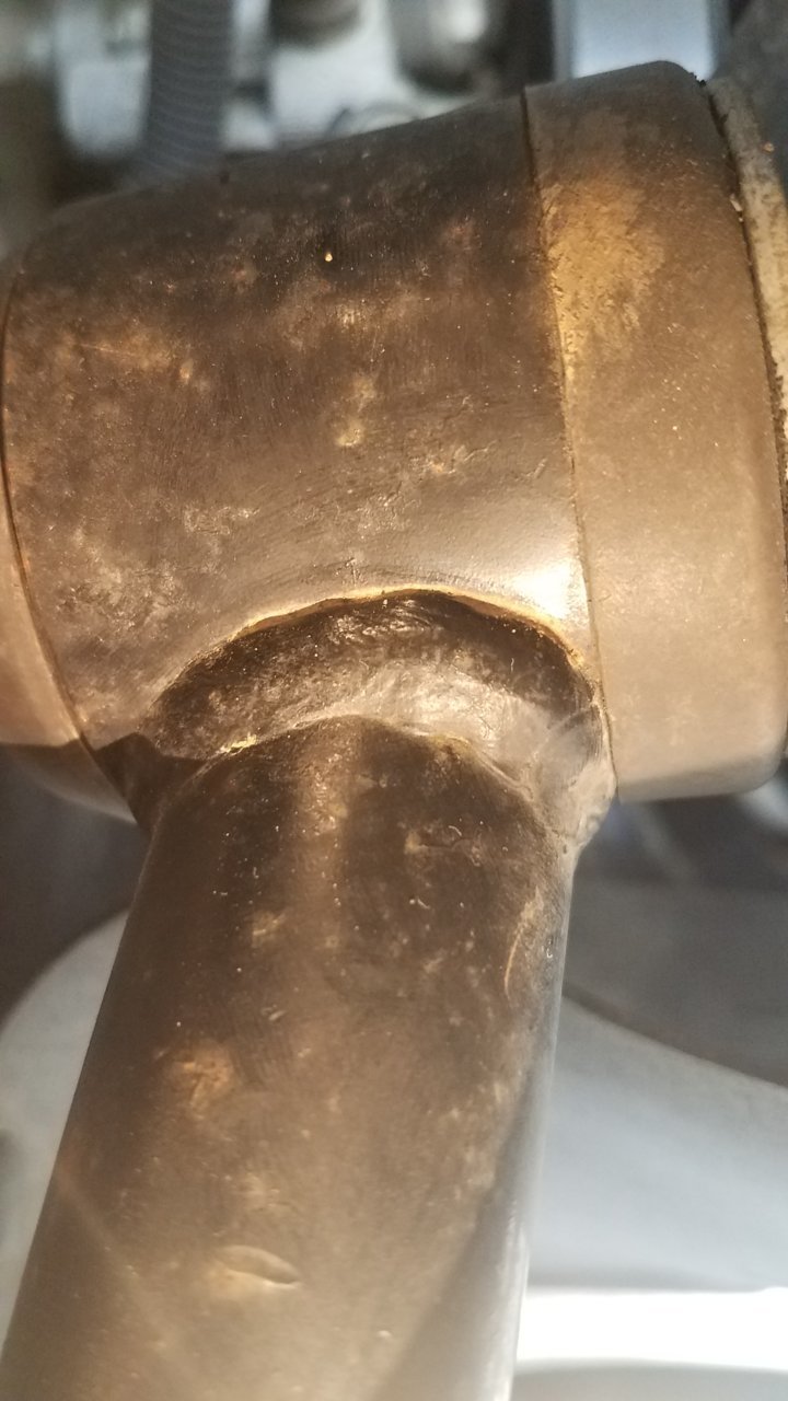

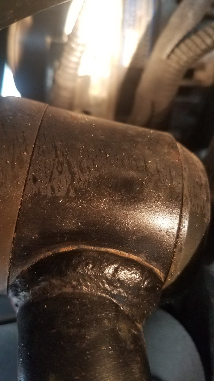

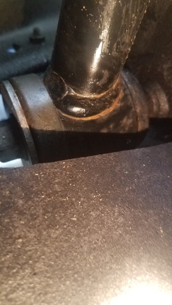

    Was looking at my UPC's today and and noticed the following in no particular order:
    Doesnt look like there are any cracks right now, but that is where the cracks start at the toe of the weld. I bought them used from someone off craigslist about 4 years ago, so they could be the old ones. Thoughts? First thing I'll try is to contact SPC, but not expecting to get far.

    looks fine, i see no problem, those are not cracks in the weld IMHO

    Yeah I updated the original post, I dont think there are any cracks either but that is where the cracks start and the rust isnt helping

    yes it is where the cracks where coming from on the first version of spc arms
    i have the arms pictured and have those same marks as well, been keeping on eye for years now and nothing has changed, i went deep into the topic with spc, contact them and ask for Tom, he is very helpful and will go into detail about this

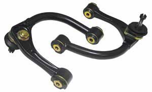

    i think technically the arms you and i have are the second generation
    half is forged and the other half is that round steel piece
    i believe the first version, the one known for crack, was all round steel, no forged part at all
    the new version available now is fully forged, and no more round steel at all
    tom helped explain this in detailed emails and phone conversations
    i ripped these pics off google, i think these are the 3 diff styles
    round on both ends version 1 known for cracks
    version 2, the ones you and i have, round on one side forged on the other
    Light-Racing-Upper-Control-Arms-for-Toyota-FJ-Cruiser-and-2003-2009-Toyota-4Runner.jpg
    and lastly the new version available now, forged on both ends

    So after taking my old ones off and comparing I had the 2nd version of arms but they had the 1st version style bushings, maybe that made a difference in the swap out.
