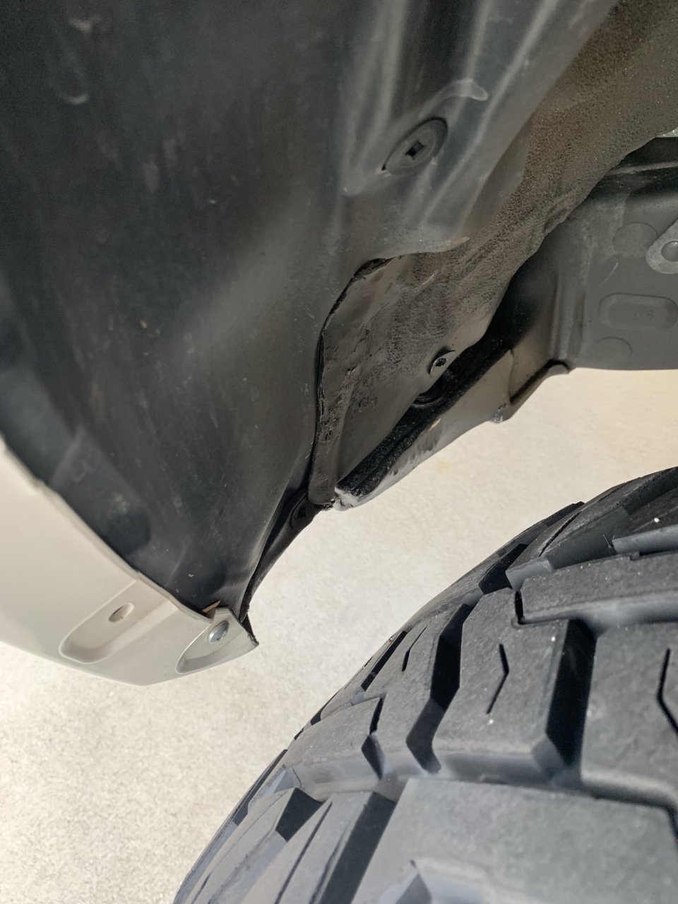

    By the looks of your picture.. you need to cut more.

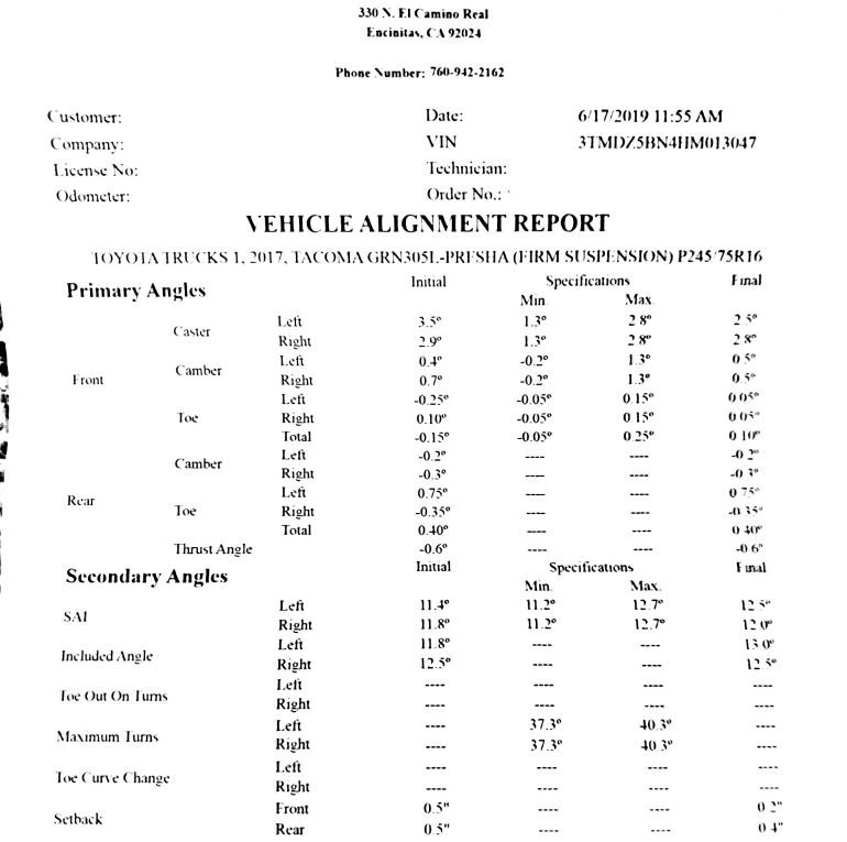

    This is kind of interesting, looking at my alignment report, it seems they dropped my castor from 3.5 to 2.5 on the Front Left and 2.9 to 2.8 on the Front right
    But yea I assumed all tires are created differently, but this just seems to be a significant change when turning 1/2-3/4

    are your lower A arm cams adjusted to move the wheel as far forward as possible?

    Just cut the plastic off. What I did then ended up pinch welding too

    My pinch welds were flattened when I did the CMC. At this point I think its just the plastic as well

    285/75r16 Toyo RTs with 16x8 0 offset and 1.25mm wheel spacers. I still rub my CMC slightly offroad and reversing. Just cut what needs to be cut. It really isn’t that bad. I said the same thing years ago.

    Just do some trimming on the plastic and cab mount, even if you have to pay someone to do a good job it's worth it.

    I don't think he wants to cut the plastic guys, I think half a dozen people have suggested it but he doesn't respond to them lol.
    In my experience even with 33s more positive caster helped but I still had to trim the fender liner and fenders (different gen Tacoma though). But when it comes to 35s there's just no way you're going to avoid trimming that, especially if you go offroad.

    I didn't want to either, but here I am with no rubbing. OP will come around:)

    Other option is to heat it up with a heat gun and try to re-mold the plastic, but I don't really see how that would be better than just cutting it. I think a clean cut will look just fine

    I think a better alignment is what is needed. Move those caster numbers to 3-3.5 and doubt there will be anymore rubbing.

    tell them to max your caster out then see where you are. No point on changing arms imo. just trim that shit.

    Yea at this point Im going to take it back to the alignment shop and see how much more castor I can get out of it and see what happens. No rubbing on my last pair of tires vs my new tires now and the rubbing thats happening now, the delta seems too high IMO.
