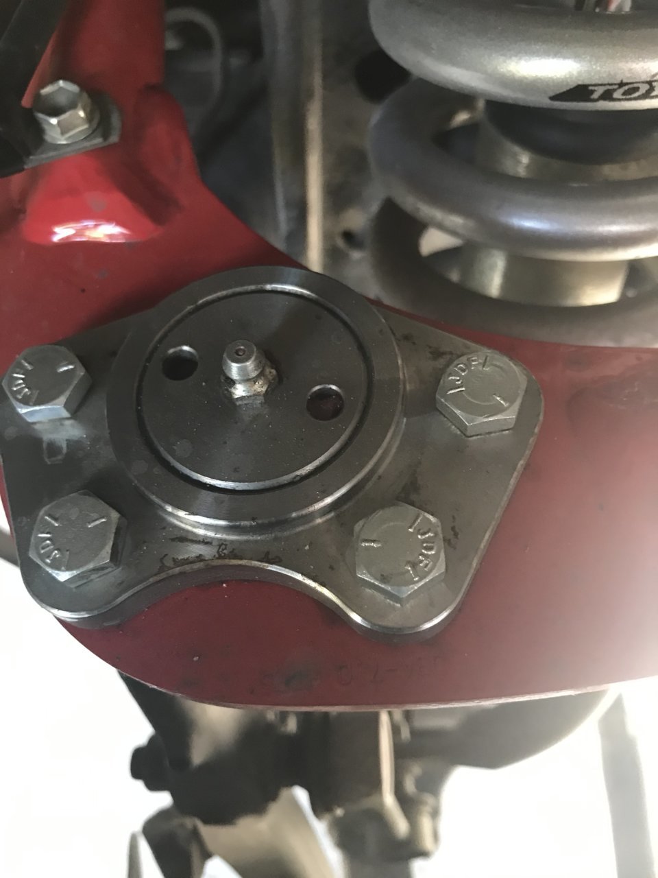

    3" ToyTec coilovers, JBA UCA's, Bilstein 5100's
    1.5 years old. No rust issue n Texas. Everything in the north rusts6C46A04A-6500-4460-93DE-318208536EE8.jpg

    The SPCs are easy to adjust in your driveway using the instruction sheet they come with (or download it off their website). All you do to adjust the caster and/or camber is loosen the top nut, then with the tires off the ground you can turn the ball joint by hand and that will change your caster. On the instructions they have a diagram showing which position the ball joint should be in to get different specific numbers. There's a slot for the ball joint to slide toward or away from the truck as well to adjust the camber. Once you get it in the position you want you tighten the top nut and you're good.
    Afterward it would be wise to have an alignment shop check your numbers just to make sure you got it even on both sides but it's not hard to do yourself.
    FWIW most people just install SPCs on the normal setting and keep them that way...with the SPCs and the JBAs you automatically get better caster and should be able to achieve 3 degrees via the lower settings at an alignment shop without even touching the upper ball joint. I keep mine on the normal setting and my local shop was able to give me 3˚ easily.
