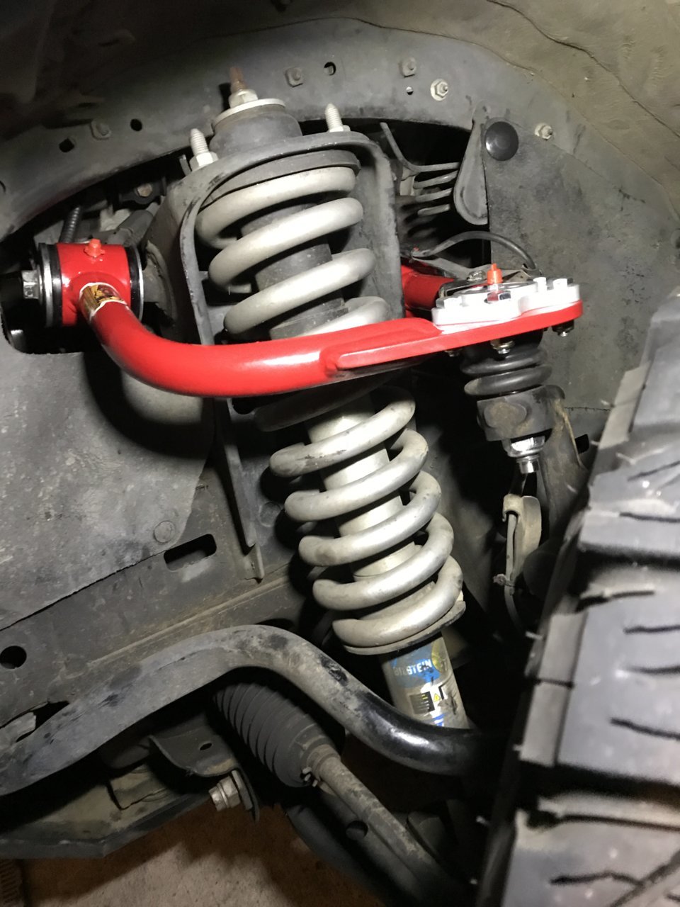

    They're in! Alignment in a couple days.

    Hell ya looking bad ass, some guy was saying on another page that he put some on his 4Runner and his alignment was off and they couldn't get it right so on and so forth, hopefully thats not our case.

    the alignment shop probably said the caster was way off and couldnt get it within spec but the jba arms run high caster so spec will be out but its designed to be like that, If i remember correctly im at 4 degrees caster with my jba arms in. its red according to spec but thats rite where i wanted to it. Running 285-70-17 with no rubbing at all, not even close to the cab mount.
