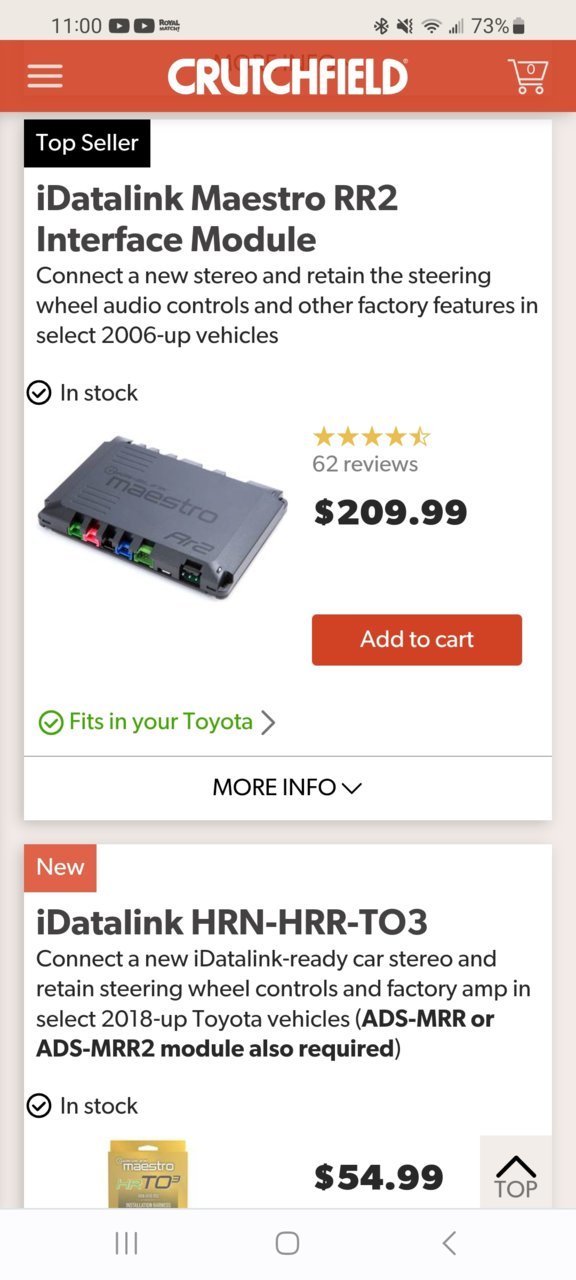

    You lose no functions if the HU is replaced with the supporting devices.
    A list of what is needed can be added to your cart at crutchfield.com with a single click.
    Total cost is in the 200$ area for the additional parts. I haven't been on crutchfield in a while so this may vary.

    Just like this. Check the websight for more info...

    There a basically two options. You can do the research to find which one is more your speed financially and doability.
    1) Add a line out converter (LOC) and retain your factory HU. You will want to also add a 4 channel amp as the o.e. HU power is around 7 watts per channel.
    2) Replace the o.e. HU with one of your choice.
    Probably Stull gonna want at least a 50 watter per channel amp for any sound quality.
    The non JBL Tacoma is one of the worst o.e. radio set ups I've ever heard. They definitely put their money in other places, understandably

    So who here has opened up or removed the stock radio on the 2023 tacoma ?
    At Crutchfield I found this
    https://www.crutchfield.com/p_700650450/Alpine-iLX-W650-and-4-channel-Amp-Package.html?tp=72334
    would this fit with the amp on the back as in the pics
    So if I understand this right if I replace the HU and want to keep the backup camera and steering wheel controls i would need
    a idatalink interface module or a Maestro radio replacement / steering wheel interface Correct??
    or if at crutchfield I enter my tacoma's info and it list the touch screen radios that will fit do I still need an interface unit to??
    plug & play?
