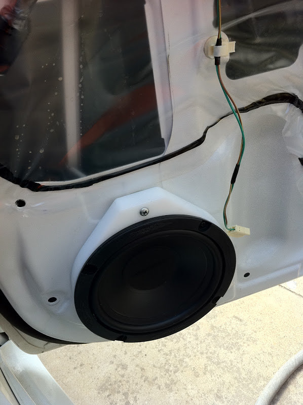

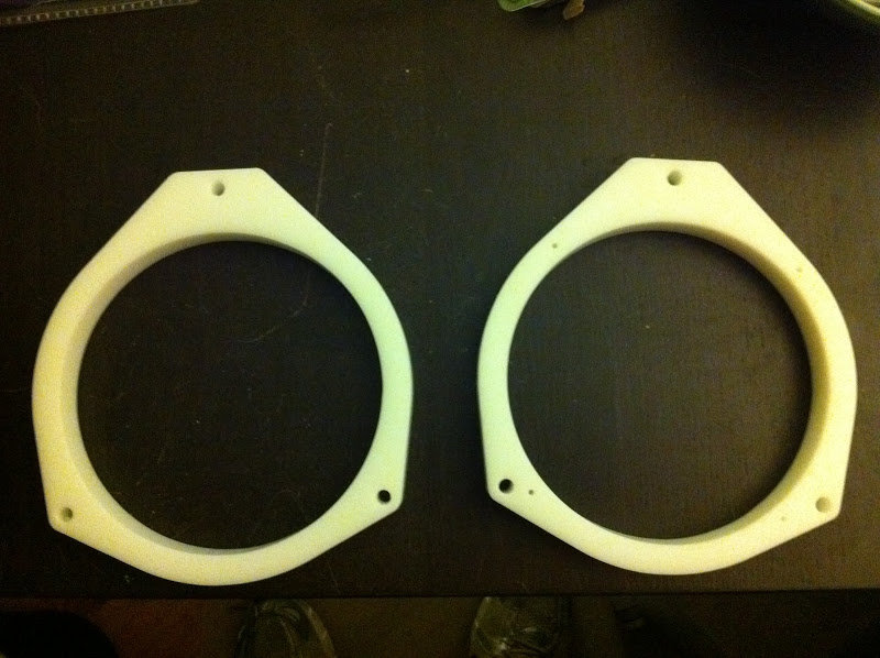

    I am not a fan of MDF as that is no place for wood product lol. its in your door which will see some moisture. so if you do use mdf seal it and or paint it
    i like to use either HDPE or abs plastic.
    i made these for my suby (still trying to figure what i want for the truck)
