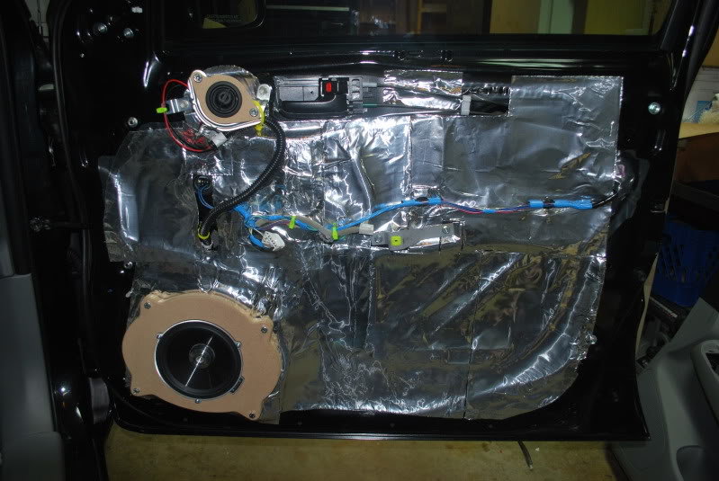

    Tim:
    This pic is for you. I am a newbie with sound deadening and I felt the process was straight forward and not difficult at all.

    Nice !
    thanks for the tips. i'll be sure to be careful with all the clips.
    95SLE- where did you put the crossover box?

    Up underneath the dash next to the cab wall. There was a handy bracket to tyrap the crossover to. I still have to install the one on the drivers side. I already know that under the dash will be a bigger challange on the drivers side. I would like to keep the crossovers in the cab and not in the door. ;)
    Fishing the wires through the rubber plenium between the cab and the door was not hard but you do need to be careful. I used a long tyrap as my fish tape. It worked great. I will try to take a pic when I start the drivers door tonight.

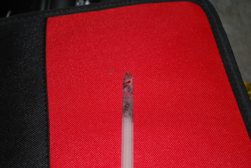

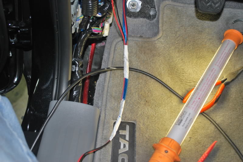

    Tim:
    I made a lot of progress tonight. I ran out of sound absorbing mat and was able to pull the cables into the door.
    I drilled a hole in the end of the tyrap.

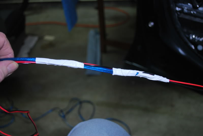

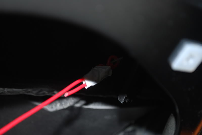

    Next I tied and taped the positive feed, for a LED project, to the tyrap.
    Then taped all the other wires making sure to space them out along the pull.
    Badda Boom the wires are through the conduit and into the cab.
