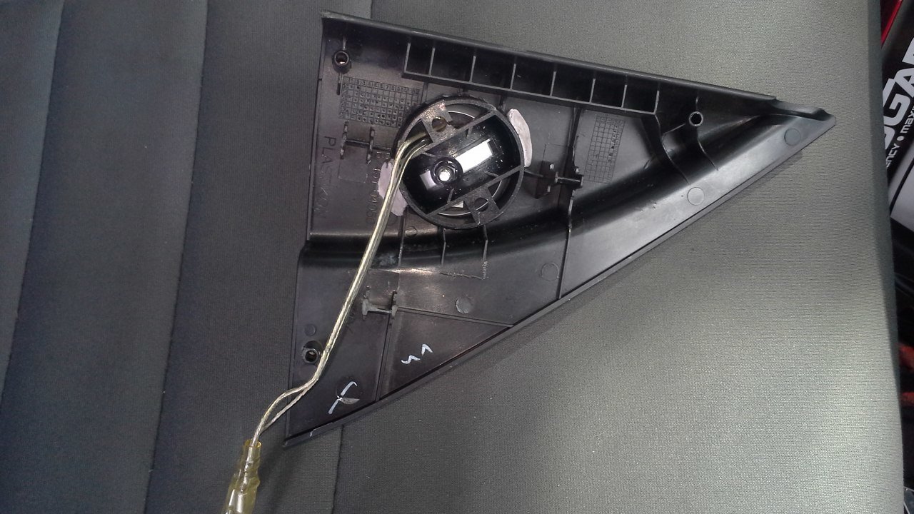

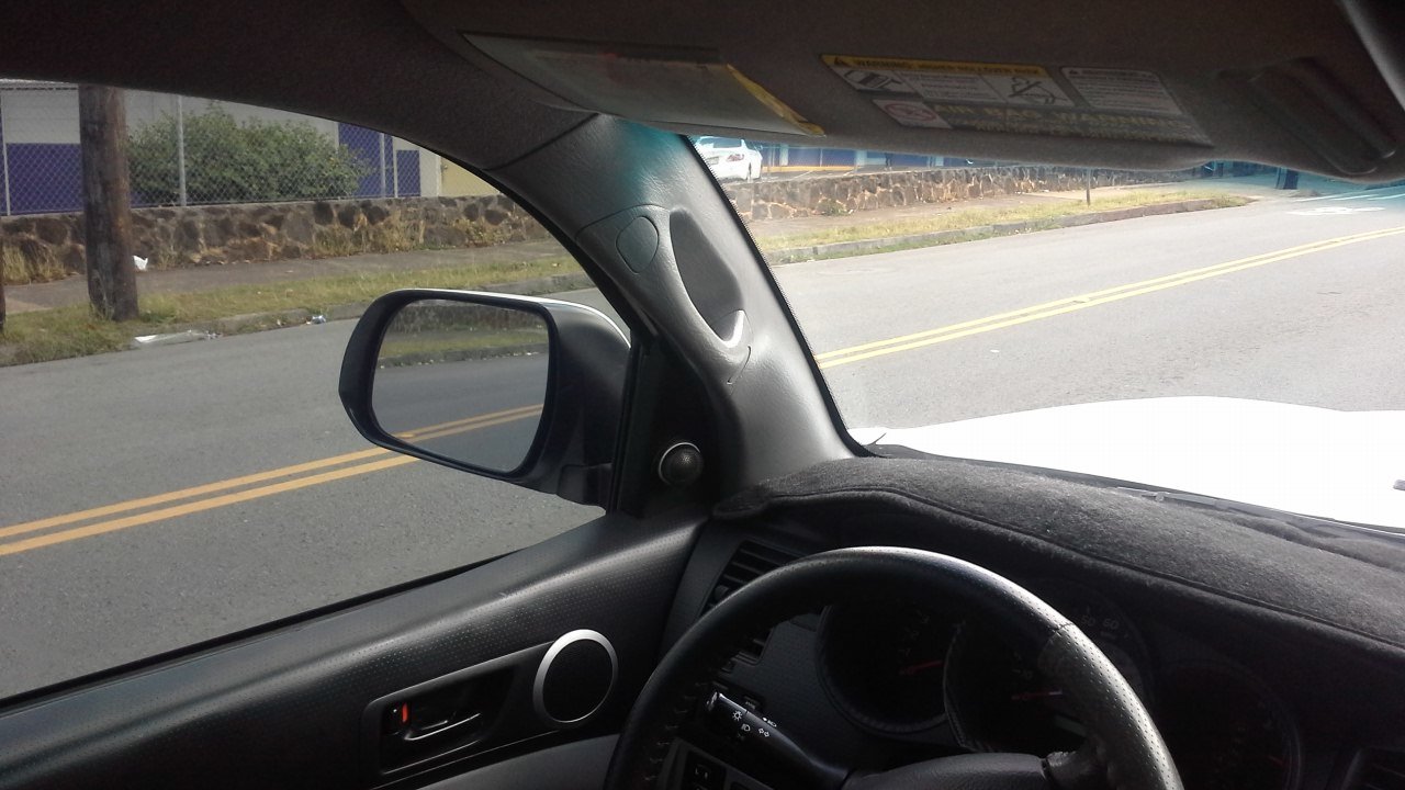

    Try search . People also just cut out old tweeter from factory one and mount after market one in place

    How did you wire these up?

    Running alpine 445u amp but using factory wiring . Running factory wires to cross overs . Need to watch out were you splice . I believe it goes to tweeter 1st then woofer . Forget which one first . You splice wrong one you wont get sounds . Then just go to other wire to splice . Sorry if confusing . Been awhile
