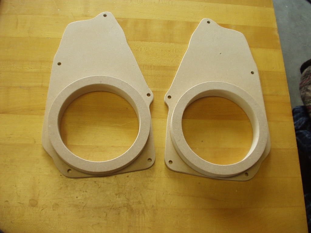

    Polowhitfoot, since you have a 2002 you will need a baffle/adapter like the picture below and ideally you would need a fairly shallow mount 5 1/4" unless you have a desire to cut up the doors in your truck to fit a 6.5". :eek:

    So in the picture above, I see no enclosure, just the bracket. Do they function as a baffle or is there something else that comes with them?

    A baffle is not an enclosure however an enclosure can function as a baffle (check the explanation sooner gave above). Technically I guess you could say the larger portion is the "baffle" since it separates the back wave from the front wave (fills in the door hole that is larger than the speaker opening).
    Yes your truck does have 5x7's in front however I "assumed" :eek: you wanted to switch to a round speaker as most do.
