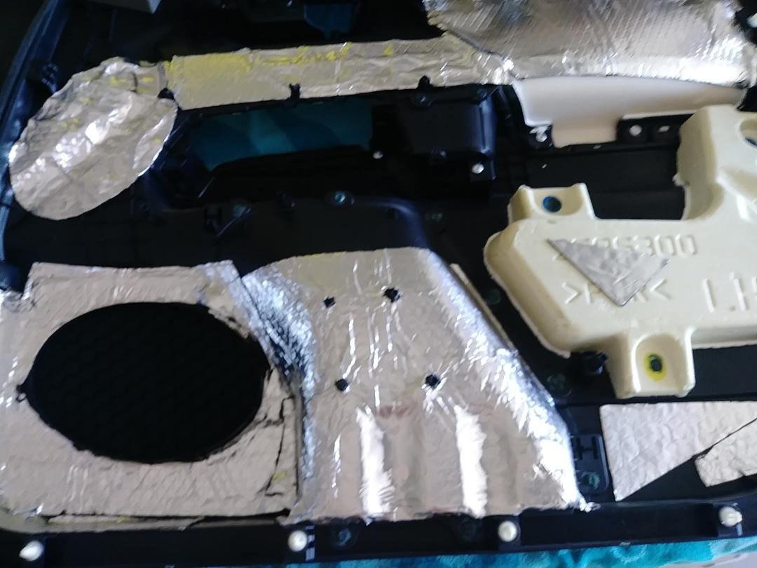

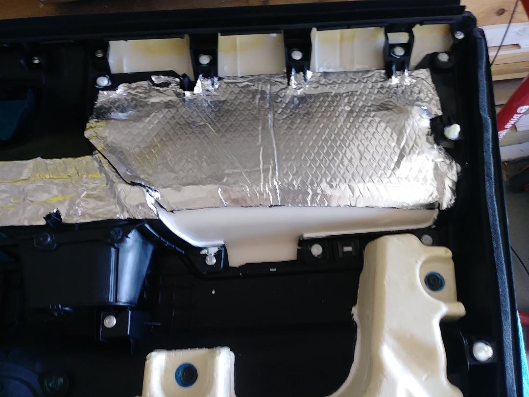

    sound deaden the back side of the door panel. i had the same issue and did that and all is good. you have to cut pieces to fit in the nooks and crannies but cover as much as you can. also i caulked where two parts came together, obvious in the pic's. all will make sense when you remove the door panel.
    also stuff like loose change sitting in the cubby in the arm rest will rattel.
    when i turned up the volume it sounded like the speakers were blown, not any more
