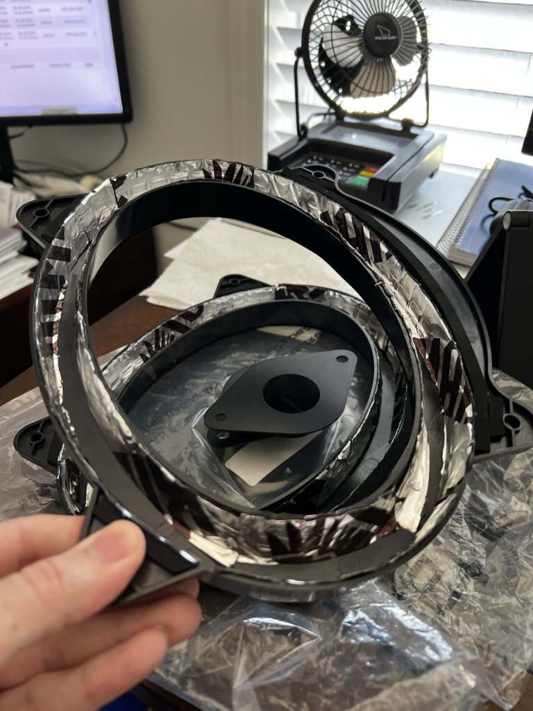

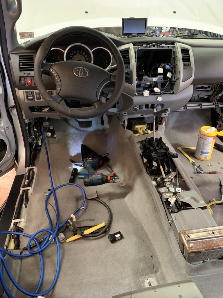

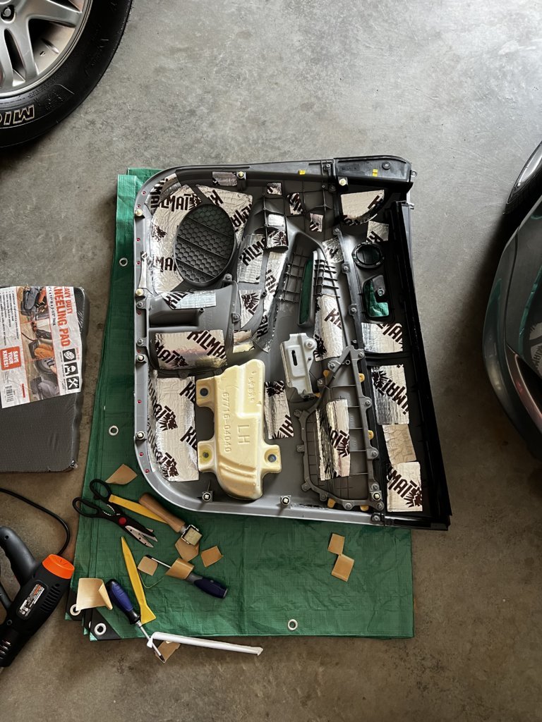

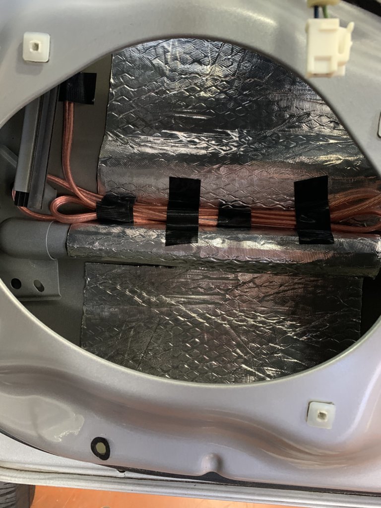

    JL make some decent components as well as some of the Kicker KS models. Its going to make a diff as to how you treat the doors as far as sound deadening and how much power you run to them. Just treating the doors alone can make a huge difference when running low power. I treated my doors and changed the headunit to a Kenwood Exelon model before installing my components and amp. Just that alone brought the OEM speakers to life until i had time to complete the install.
    When it comes to picking out speakers you have consider the type of tweeter you want, metal will be brighter and more teeny sounding vs a soft dome that will have a smoother natural sound. There are a lot of things to consider when picking out speakers. If you are running low power, a very efficient speaker will make a big difference on how it sounds with lower power.
    Couldnt find the pic of the complete inner door shell covered but i also treated that heavily around the speaker area to help with dampening.
