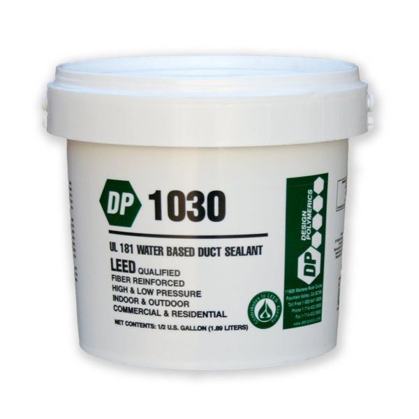

    Wait till you see the magnet. On the stock speaker. It's like 3 quarters stacked together super small. 6x9 can hit in a small cab. It's the same as 8" in speaker terms. If you want a cheap and easy sound deadner. Go to lowes or Home Depot and get some mastic it's in the ac area. It's a half gallon . Like 15 bucks . Just smear it around the flat sheet metal in side the door in the area the speaker is . make it thick 1/4" or more maybe two coats it drys in an hr. Speed it up with a blowdryer . It helps with the vibration from the sound waves.. It's water based. And is waterproof after it drys. This is what the factory uses .and Its sold as a deadner it's just given a different name and charge more. Also try foam baffles they can sometimes help with the sound quality and keep the speaker dry from water (rain) that gets inside the door.

    Thanks Billy! I was searching for a dynamat alternative!

    that's what i have. i'd mark them as ok. thought about swapping them out for something else, but i'm too cheap.
    also highly second the sound deadner. and not just the doors. i've did the doors, back wall, floor so far. gonna toss some on the ceiling to finish it up. what a difference

    Lowes brand.

    Would you suggest the mastic or something this
    http://www.amazon.com/Constrained-D...=1-46&keywords=Sound+Deadening+Mat+Automotive
    I mainly just want to make my doors sound more solid

    The mastic is just for the skin were you can't get sheets to fit. (Cheap alternative)It's hard to get sheets inside the door on all the skin. Buy kit its better but it might need more . So then use mastic but by installing the sheets you'll cover the holes . So I guess you'll have to use both and install the mastic first . If your outside and you tap the metal with your knuckle and it goes ting,ting. The mastic will make go thunk,thunk. That's more solid right. If I had photo I would show you . What it looks like. I lost my photos . I had Windows 10 in my PC and didn't like it so I tried to go back to Windows 8 and in the process lost everything in PC I have stuff in a external passport harddrive but the PC wouldn't put the stuff back in it. So I don't have pics of my trucks and there mods any more until I figure that out there's a few in the cloud but not of taco.. I've been using my tablet. Most of the sound comes from the back wall from the driveshaft and exhaust , tires . I matted that first and it made a much better reduction in noise in cab. But in all I used mastic in all doors. I got it free from ac guys I used 3gls. i used the speaker hole and just scupped it with hand and wiped it on outer skin . As far as I could reach. Then installed the sheets(behind the plastic door molding but on door) And I went as far as making a little sealed box for the 6.5 speaker. In the 6x9 hole. At first I used a baffle it worked. But I wanted more punch out of the speaker so I made the box. With the box I got less low bass . I like that better . The subs are for lows. You can use foam in a can to help seal things up. But if you need to rewire or change things up it makes it harder. Cause the foam is in the way. The foam will keep metals from rattling. From to much bass causing a metal to rattle. Foam it. Like if the roof flexes foam in the gaps between the support beam and the sheeting the factory uses a little caulk and very little. Foam is a medicine for bass. It heals a wounds. Lol
