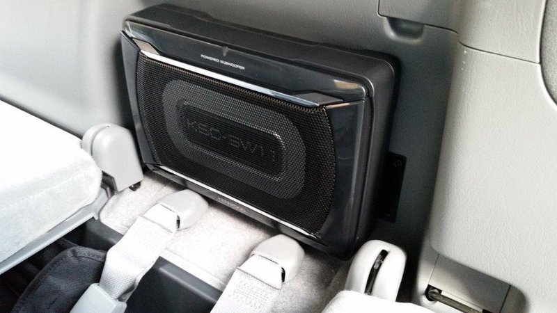

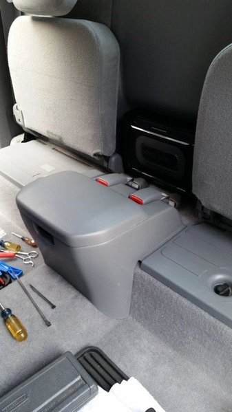

    Yea im going with frost king after reading a bunch of reviews. I'm too messy to use the putty.
    Right now I'm wrestling with getting an all in one subwoofer for the rear wall or making my own custom box.
    This is what I'm thinking of getting
    http://www.amazon.com/Kenwood-KSC-SW11-Compact-Enclosed-Subwoofer/dp/B00BO8O9XQ
    Pics from a TW member who did it.
    Thread: https://www.tacomaworld.com/threads/12vdc-to-kenwood-ksc-sw11-subwoofer.361383/

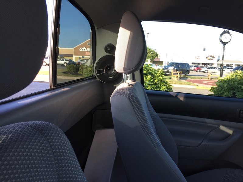

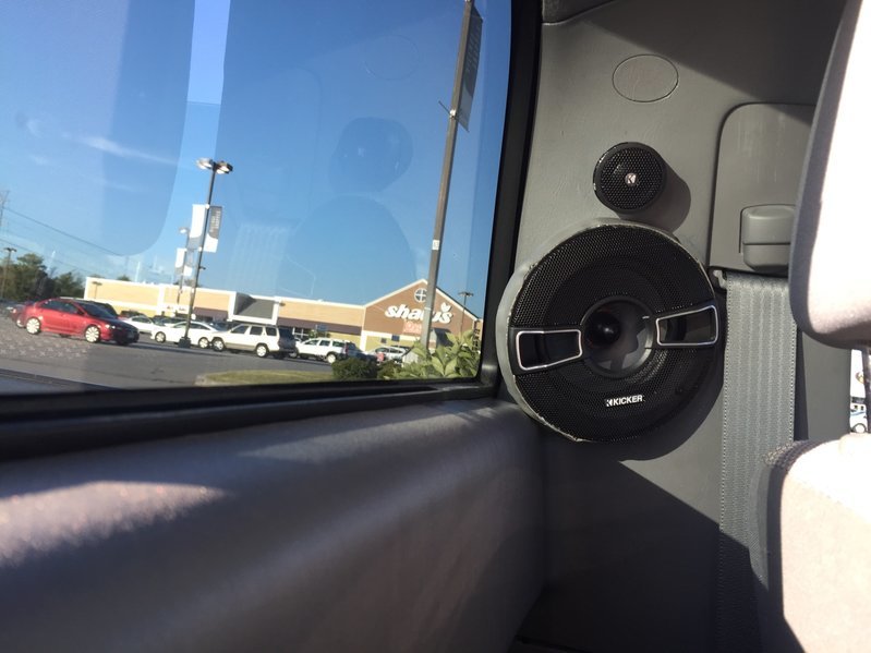

    Rear speakers

    Kicker

    BOOM! those are almost headphones :p

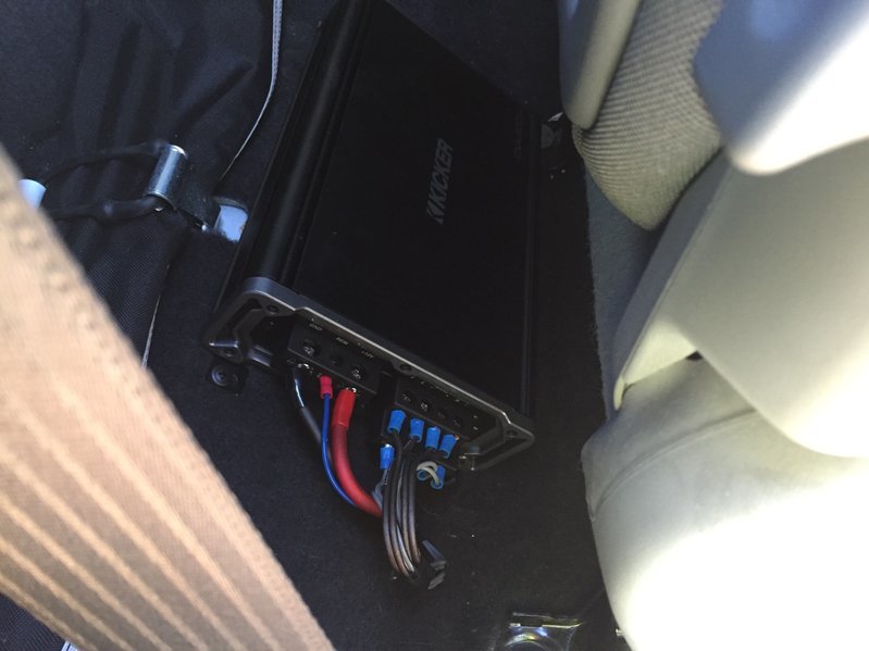

    Clean install, are you running it off the stock head unit if so got an amp?

    No I have a kenwood head unit and kicker ampimage.jpg I never keep stock head units

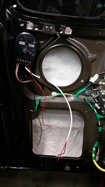

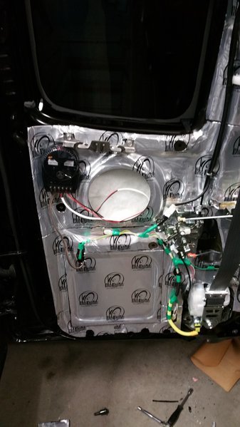

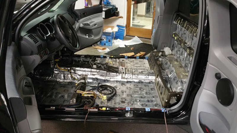

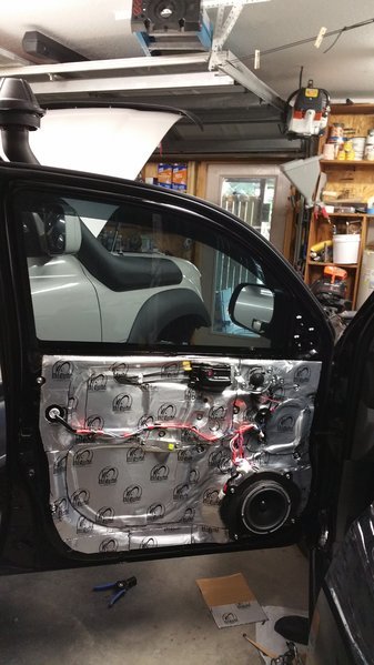

    I found this over the weekend in and old phone. The mastic is in the bottom opening in the first pic. It's white,clean and,no smell ever,heat don't bother it.and pillow stuffing in the upper opening . I used it behind the speaker cause that door is sealed. Then put the sheets on opening last.

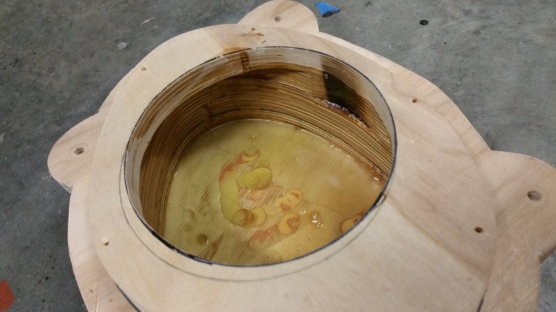

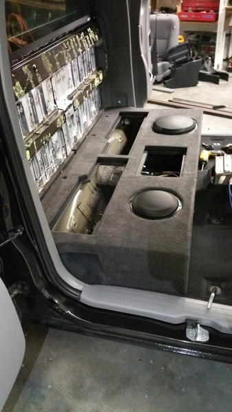

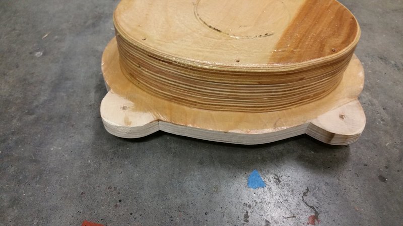

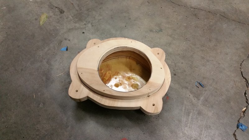

    First 3 pics are of the front door 6.5 speaker box. The the subs. Jl w3 10",jl w3 8". So the truck has 10" sub,8"sub,4 6.5" mid bass,2 4" driver,2 1" silk dome tweeter,2 1.5"aluminum dome tweeter. So I make all frequencys. When for clarity .
