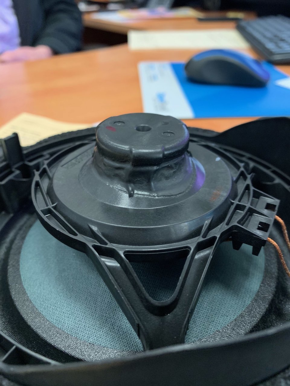

    Did anyone ever come to a resolution. Of the speaker not working . I have now had 3 passenger side rear speakers fail. We now know that right near the voice coil has melted ( see pic) the dealer at this point has no idea. Unfortunately this occurred right around the end of warranty and they say they wont cover it yet. We have completely swapped the head unit with another truck and my head unit worked in the other truck. The head unit seemed to work while the speaker was out, but now the head unit is sometimes on , then not, then some sound makes it to all speakers but crackles like a poor radio station. Any help out there is appreciated. So far Toyota is not covering this under warranty as i did not create a work order until a few months after the fact as i was not able to get there. HELP!

    How loud are you playing your speakers? the voice coil creates heat as you turn up the volume. Too much heat will melt the plastic baskets causing the magnet to shift shorting out the voice coil on the speaker.
    Your best bet is to get some better aftermarket speakers as they use large magnets that can dissipate heat pretty easy. Or turn down the volume.

    So, no I dont play it loud often as i have had concussion issues and the volume doesn’t help. For sure the magnets have shifted. You can feel the resistance moving the speaker by hand. So if its not loud and therefore not much signal to the speaker, why is it over heating. I think i may measure the ohms to the speaker and see what it reads. An more suggestions are appreciated.
