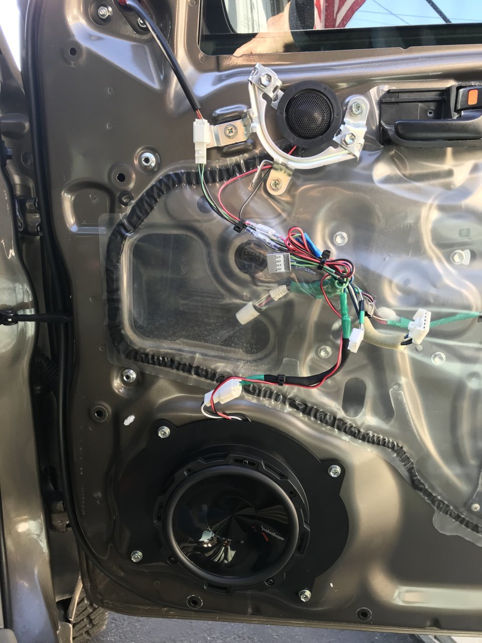

    Couple of questions...Crutchfield lists the tweeters for the Rockford Fosgate Punch speakers as surface mount only. Can anybody clarify on that, do they require major modification to install?

    In my 2015 the RF Punch components fit with the adapter in the door and the tweeter fit with a little bending of the tweeter bracket. I used RF Prime for the rear doors but any Tweeters in the rear doors would have to be surface mounted. If you reset the Crutchfield page to front doors only it will show the RF Punch tweeter will fit with modifications. I can’t speak to your sub question, I used the behind the seat storage.

    They should supply you with a metal strap that you will need to cut and bend to mount the tweeter to. Here's a picture of what my door looked like after the speaker install.

    ^^^^^^ Exactly! That photo explains it way better than I did!
