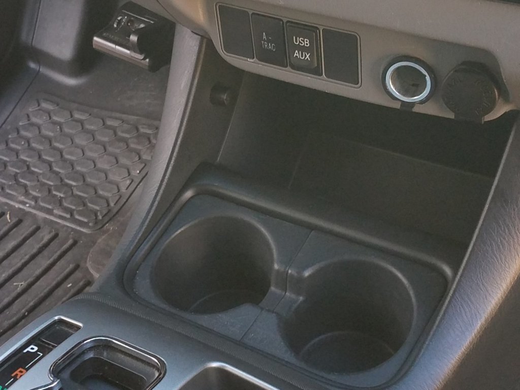

    If adding a sub to the non-JBL head unit just remember it tries to compensate for bass at low volume levels. Pretty sure there's nothing you can do about it. If my volume is below 20 on the head unit the bass is super loud... I have to briefly turn it up to like 25-30 so the bass goes back to normal then I can turn it back down again. Weird, and annoying.

    I have the same problem. I added an amp remote gain control for that. Its below the blank switch panel on the left side of the cubby.
