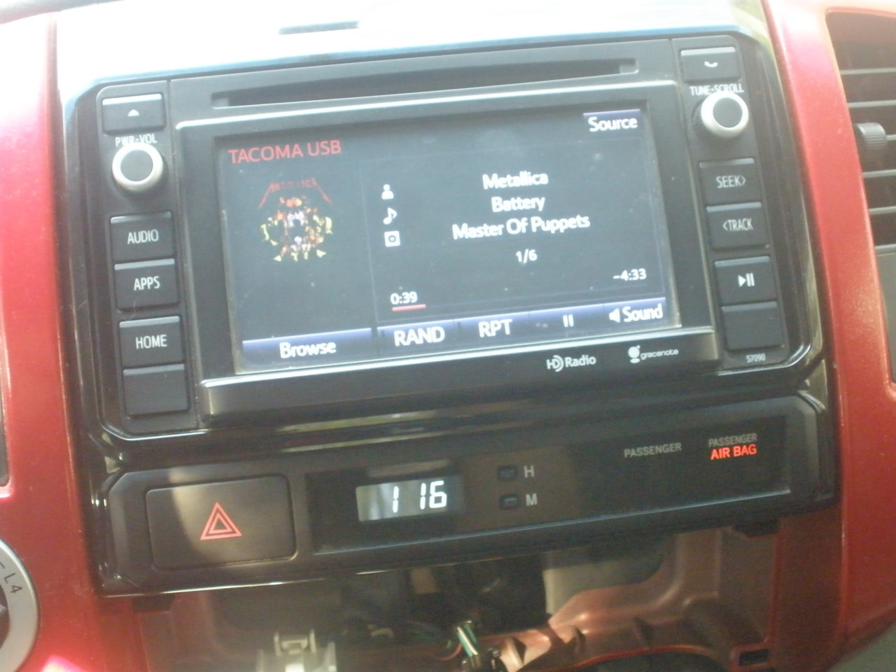

    Good eye, I had cruise control on driving 70 mph down the road while I took that pic.
    Just kidding I had the key in the switch to pull it out of park so the shifter wasn't in the way for the picture.

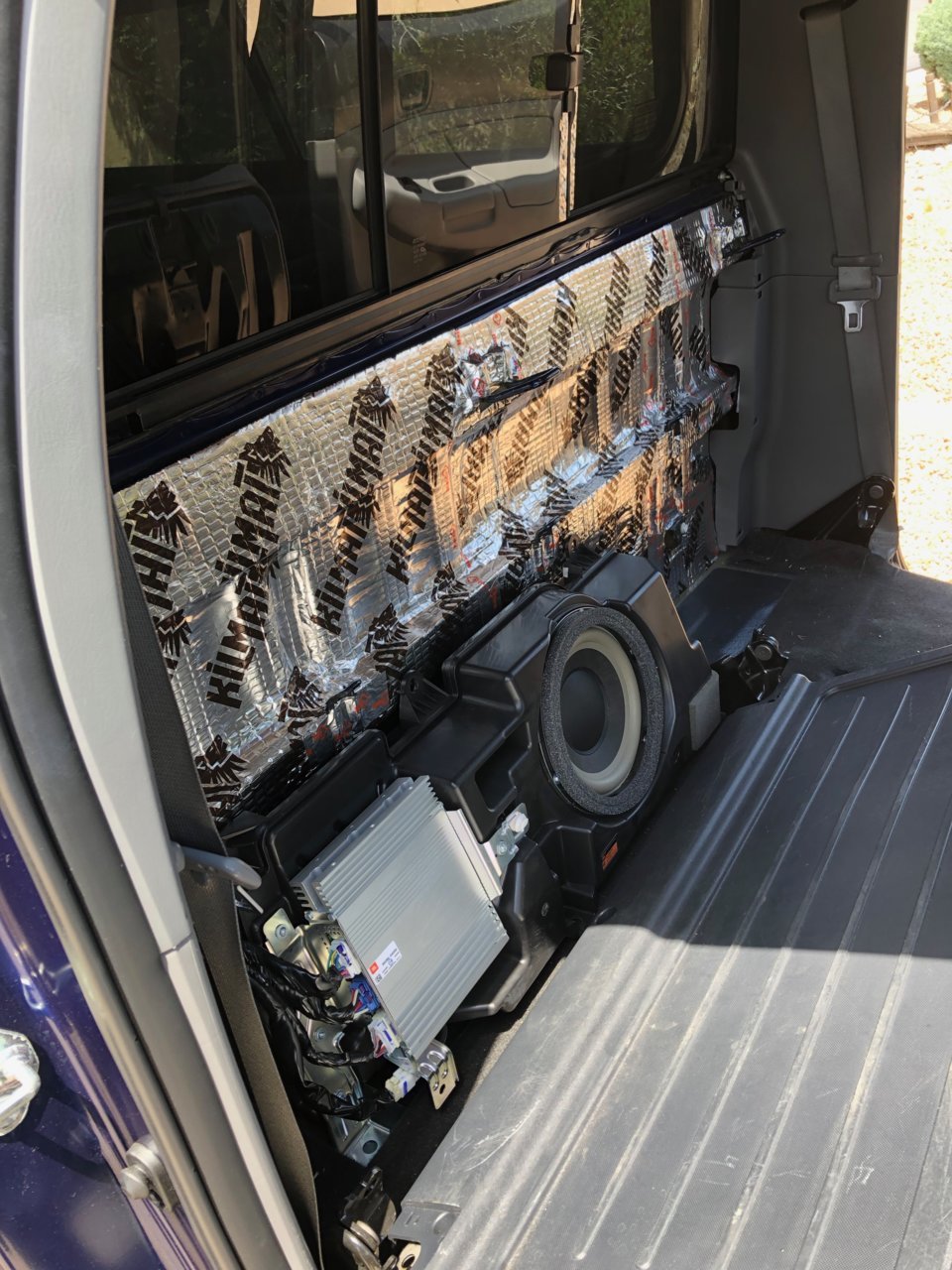

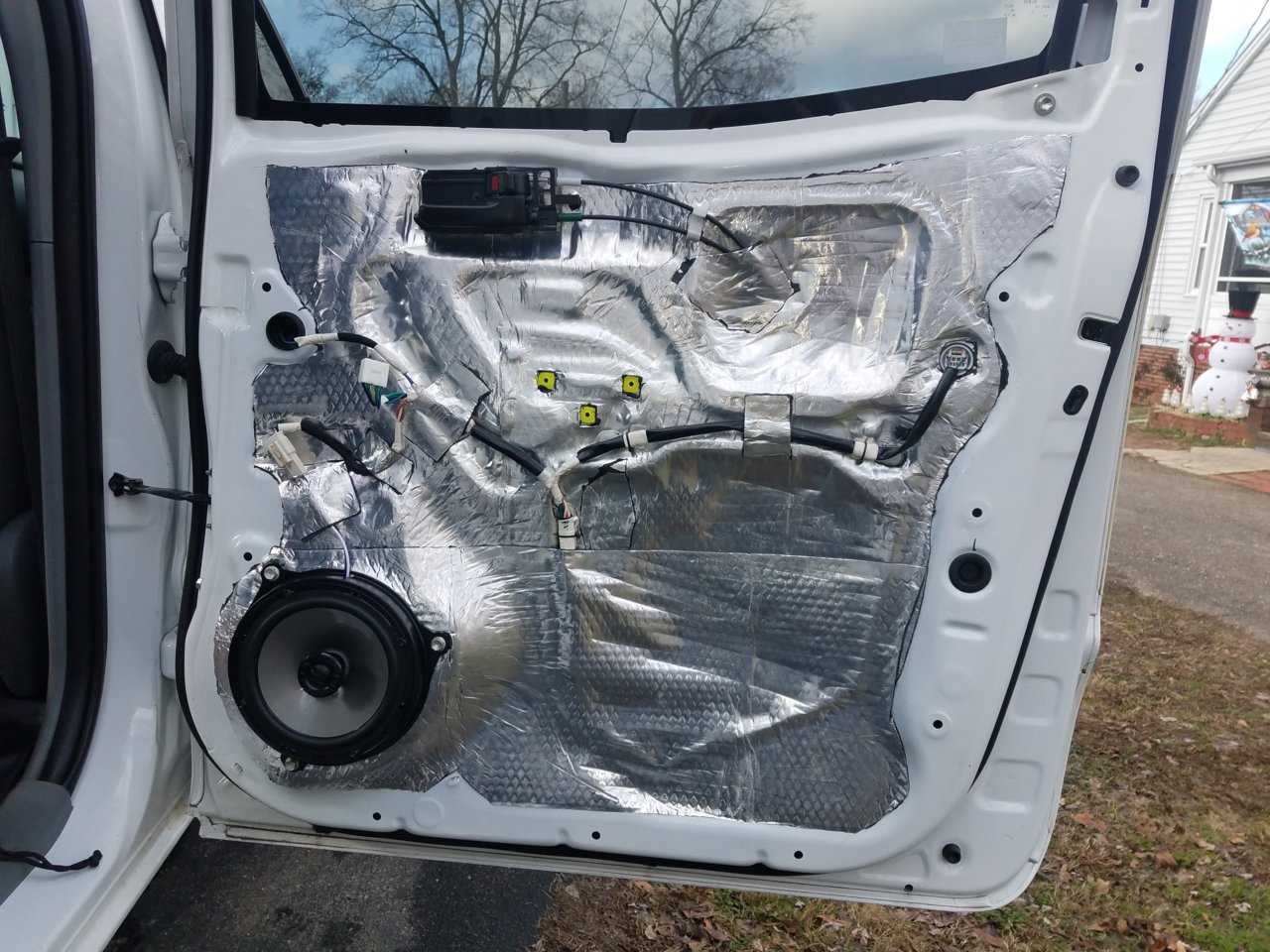

    Those panels rattle no matter what sub is used. I have the JBL system, and got rattle, until I used dampening, like Dynamat, but without the brand name. I'm in the process of doing the whole cab. Not having any of the panels rattle will make the sound much cleaner, and I believe when I do the floor, road noise will be reduced as well.

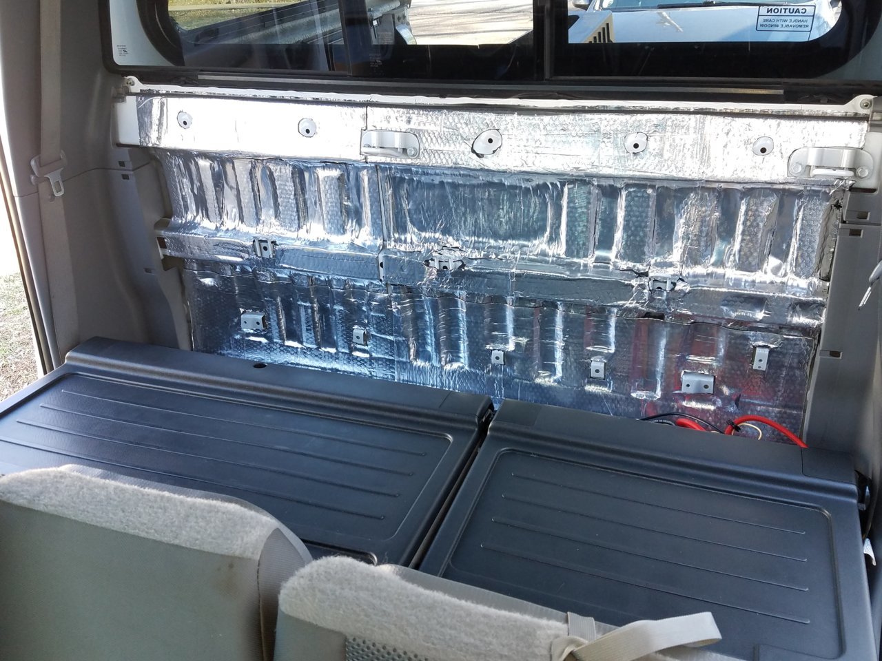

    my rear cab wall has sound deadening too. I have even placed foam tape between the panels where they meet. The sound deadening on the doors made a huge difference in reducing outside noise and greatly improved sound quality. I applied sound deadening on the inside of the door skin and the inside of the door where the vapor barrier used to be.

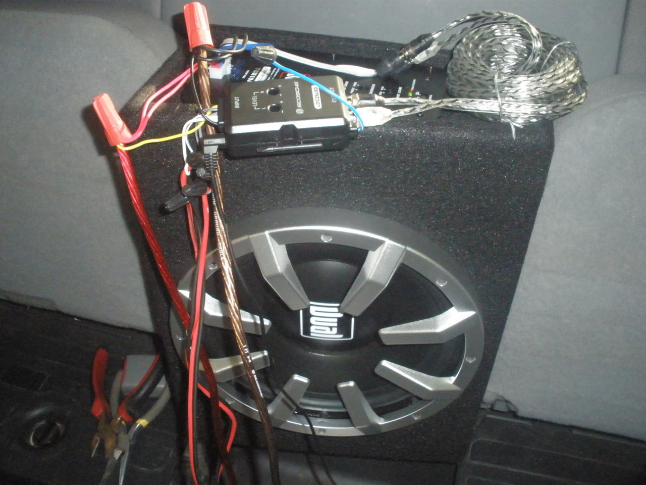

    Mokumemetalarts
    Mokumemetalarts [OP] Member
    Apr 10, 2020
    #324346
    7
    Andy
    2014 Tacoma Extended Cab
    gkomo and jbaker1976 like this.

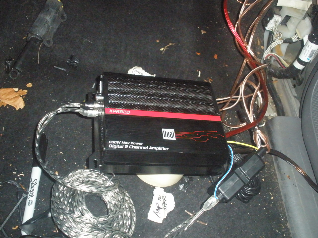

  6. Apr 14, 2020 at 3:41 PM
    #26
    Mokumemetalarts
    Apr 10, 2020
    #324346
    7
    Andy
    I got it far enough to do a smoke test and not a whiff!! I'll finish the install tomorrow and make it not so everywhere...
    Thanks to everyone!! you guys are great!
    The signal check went well, once I got the settings on the line converters adjusted.
    jbaker1976 likes this.

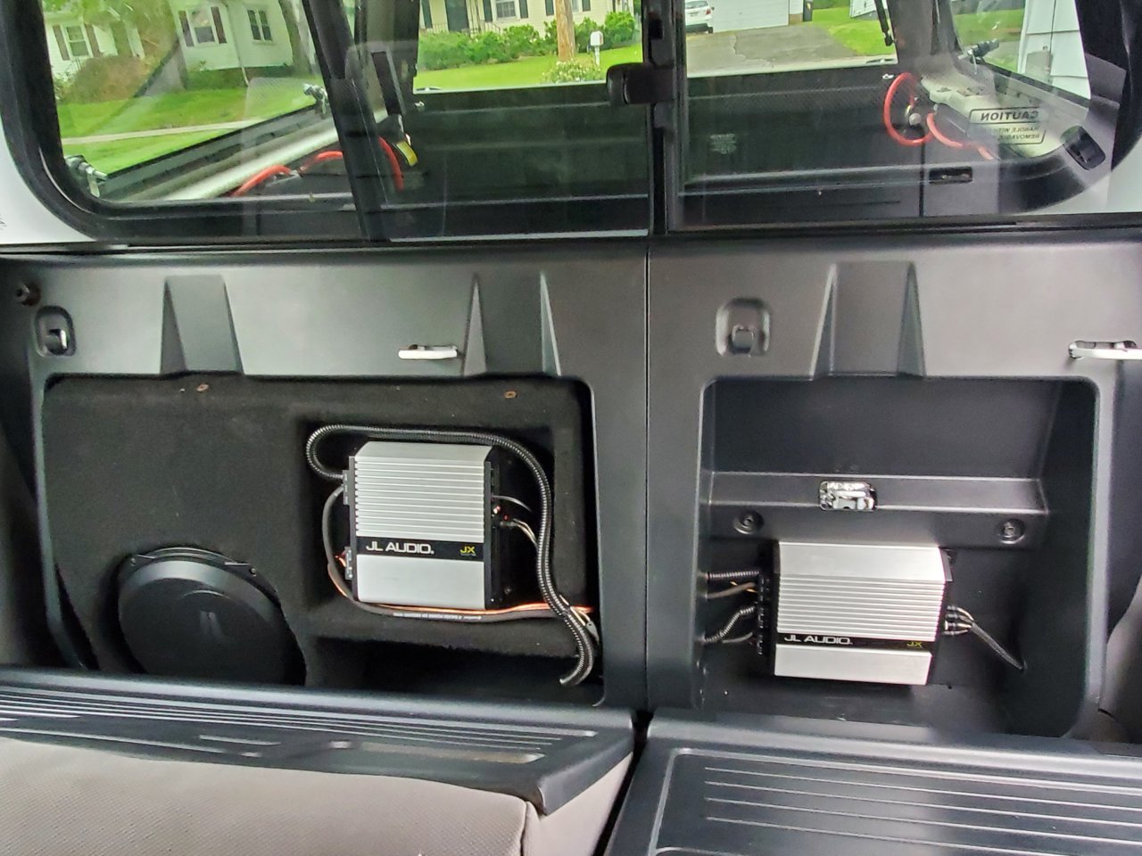

    I hope the line converters work out. If not try the pac line convertor at the bottom. I initially just added an amp and a 10 sub using this.
    https://www.amazon.com/dp/B00CQUL240/ref=cm_sw_r_other_apa_i_tcKLEb628BNSQ
    The low pass filter in the amp must have filtered the noise out on the sub.
    I quickly decided I needed mid bass for a quality sound. I added JL Audio in all 4 corners with component tweeters and bought 2 more of the line converters without the adapter for the stock harness.
    But when I used the line converters for the mids/ highs I got a shit ton of noise. I ended up using the powered version of the 4 channel pac.
    https://www.amazon.com/dp/B00F0YCK0E/ref=cm_sw_r_other_apa_i_rRJLEbRH19Y09

    Line converter bad. Line out good. Lol
    Think about it. You're taking an amplified signal, noise and all; and changing it into something that can be amplified again, noise and all...
