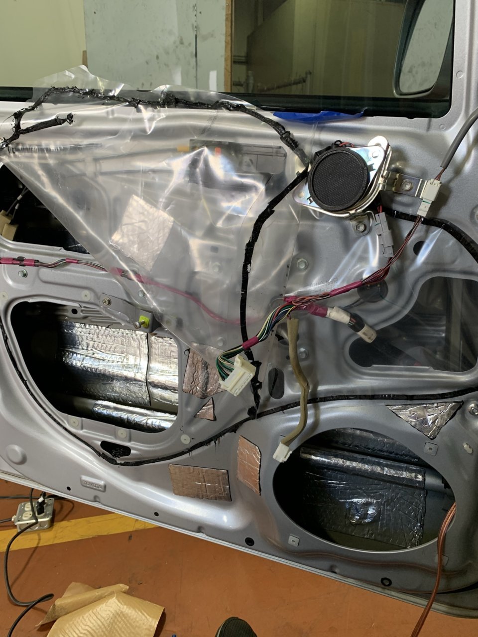

    I used Noico. So take the door panel off and cover any other areas inside the door itself and around the speaker. You don’t have to have full coverage, just any areas that stand out. I put several large pieces on the outer door skin. Maybe this pic will give an idea
    You can see the silver Noico sheets
