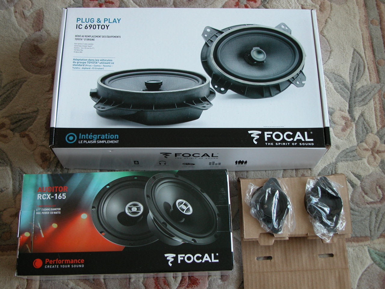

    I think @ToyoDrew had some knowledge that he shared in another thread. Somebody posted pics of the stock JBL speakers, which seemed to have bigger magnets than the non-JBL, but they looked to be about the same general construction. I believe the front speakers are also wired in series rather than parallel, so wiring gets a little more involved. Just plugging your info into Crutchfield reveals some options that are quite different from non-JBL. Seems you could do Memphis Audio in the front, but rear they only have component and you'd have to mix another brand in.
    Might be best to call Crutchfield and talk through options . . .

    The Focals made for Toyota should bolt right in. Order from Crutchfield, and if they don't work it is easy to return.

    What he said. The Focal IC 690Toy is plug and play. Has the Toyota mounting brackets installed and plugs into the OEM connector. The RCX-165 came from Crutchfield with the no charge Toyota mounting brackets and wiring pigtails to plug into the OEM connector. They also provide concise install instructions specific to your vehicle. Crutchfield is very customer service oriented and will gladly accept returns if you are not pleased with the item after installation.

    Yes. The guy at Crutchfield said that the Entune head is actually a very good unit and no need to upgrade.

    I think you will be very happy with Focal. I just installed the IS690Toy kit which includes the front tweeters and the sound is night and day from stock.
