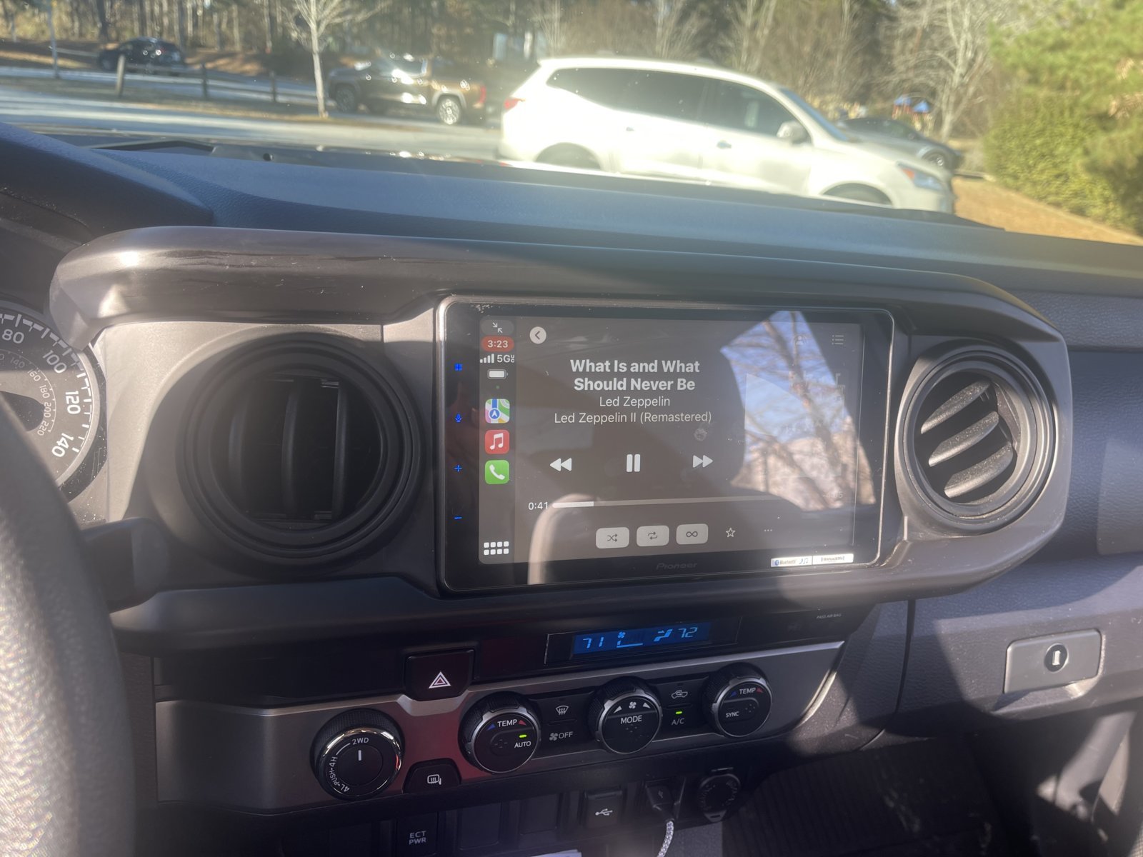

    I upgraded my audio and man am I glad that I did. First up was the (Subaru kicker tweeters for the dash,$90.00 true plug and play.) Next was the( kicker door speakers 6 & 1/2 fronts and 6& 3/4 rears.$67.00 a pair) Sounded ok but still flat. Then came the (Pioneer WMH-WT3800NEX $589.00) with an (Alpine KTA450 amp$200.00) Maestro and some twisted pair rca cables. Tuned it myself and this things sounds great. (Not as good as my Subaru with the Focal speakers but pretty damned good for the $$. All in $1200.00 including the Maestro install kit. I did alter the Trim bezel to make it more flush fit. I am going to look into a bezel out of one with the JBL system, they have an 8" screen as opposed to the 7" that came in my SR. The new unit is a 9" screen with WCP.

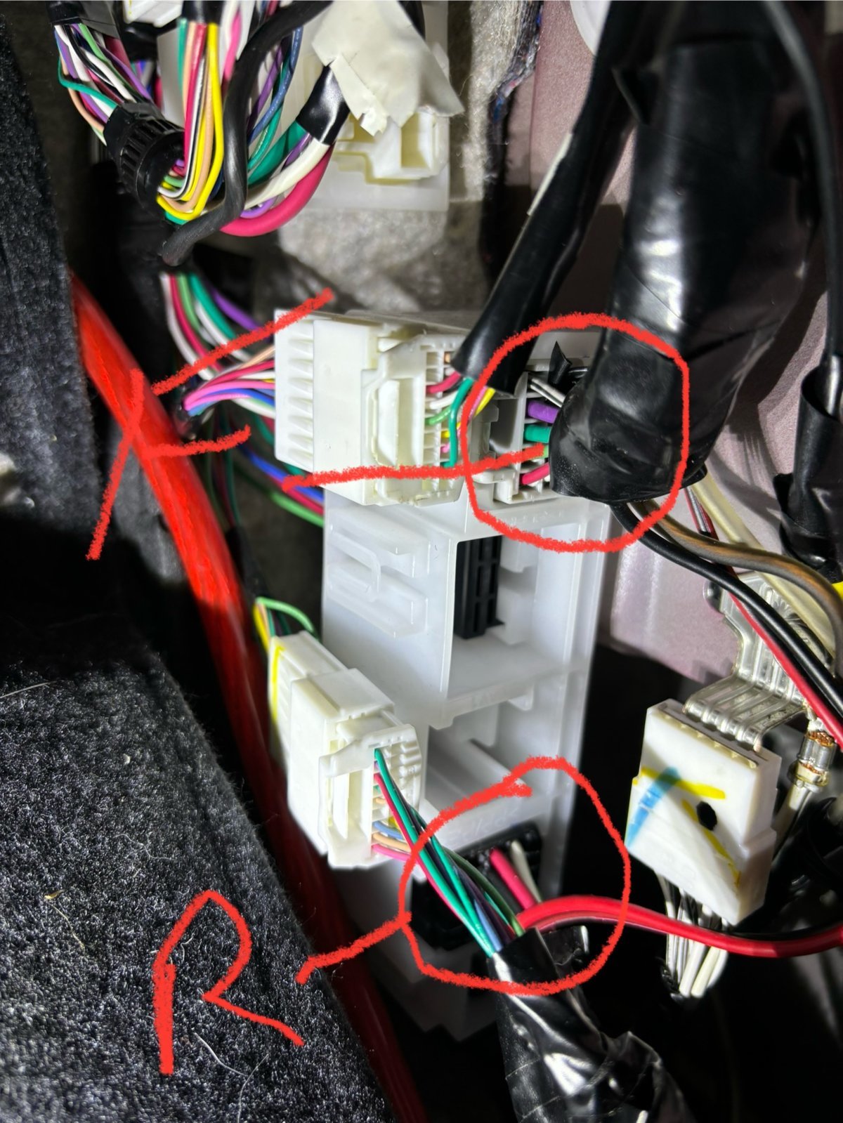

    I did make a thread back when I did it like 2 years ago but deleted it after people said it would blow my radio. 2 years later still going strong. I would definitely replace the rear speakers well I did all of them,the cheapest speakers you will ever see is in there.
    I’ll get you some pics it’s pretty easy of what I did.

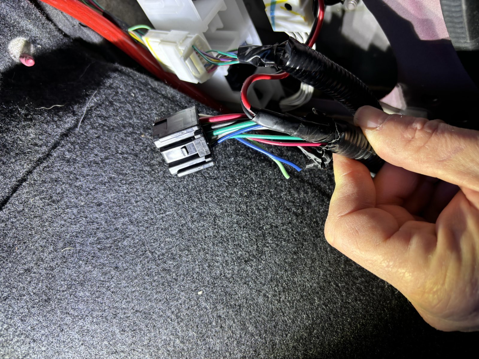

    I finally got a pic of this again. This is behind passenger side kick panel.
    Connect front to rears. surround sound now.
    Pull the front plug. Find the two wires twisted together blue/ gray on my 2020. pull back the loom find the wires skin back the wire 1/2" or so to reveal the copper wire. go to next step.
    Find the r rear plug from pic above...peel back the loom....find the 2 wires twisted together.... my 2020 was blue/light green.... cut these wires not so close where you can't put them back if necessary (you will not hook up the wires from the connector these just stay unhooked...grab a new piece of wire connect rear wire to the front wire previously found. I soldered mine in the you could t-tap for a test or leave it this way. Repeat same on drivers side I didn't take any pics of that side its pretty easy to figure out the plugs and wires. You now have the front signal on the rears. Ive had mine like this over 2 years no issues and I listen to my music around 35-40 volume...pretty loud, for anyone that says this will smoke the radio.

    My 2 cents: Buy or build yourself a harness but don’t splice into factory wire. Besides other issues you may be setting yourself up for, down the road you may want to go back to the original wiring (to sell your truck) or maybe improve upon what you’ve already done. It will be easier to move forward if you follow standard practices.

    Some cheap harness that you bought or made isn’t going to be a better connection than a soldered wire and you wasted a ton of time making it.
