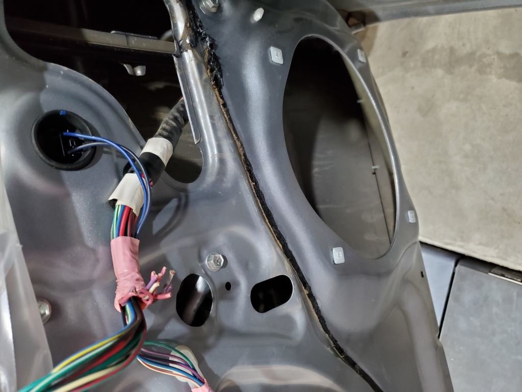

    Hi all,
    I have been searching for this for a bit, can't seem to find something on Google or various forums that match.
    Have some clipped wires from stolen front speakers and trying to figure out which color is which. This is a 2014 non-JBL system.

    Looks like they clipped more than your speaker wires....

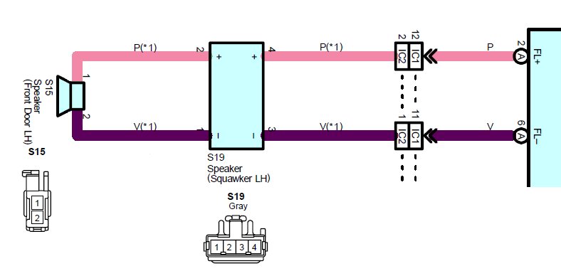

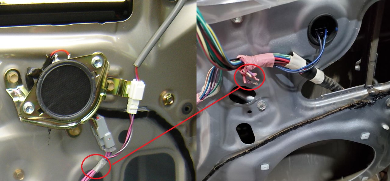

    Thanks for the diagrams - very helpful. Yes they cut the power mirror wire too and took the brakets for the tweeters. There is a bundle that runs up from the cut section to the tweeter and then past it to the mirror. I had found that wiring but not the speakers.

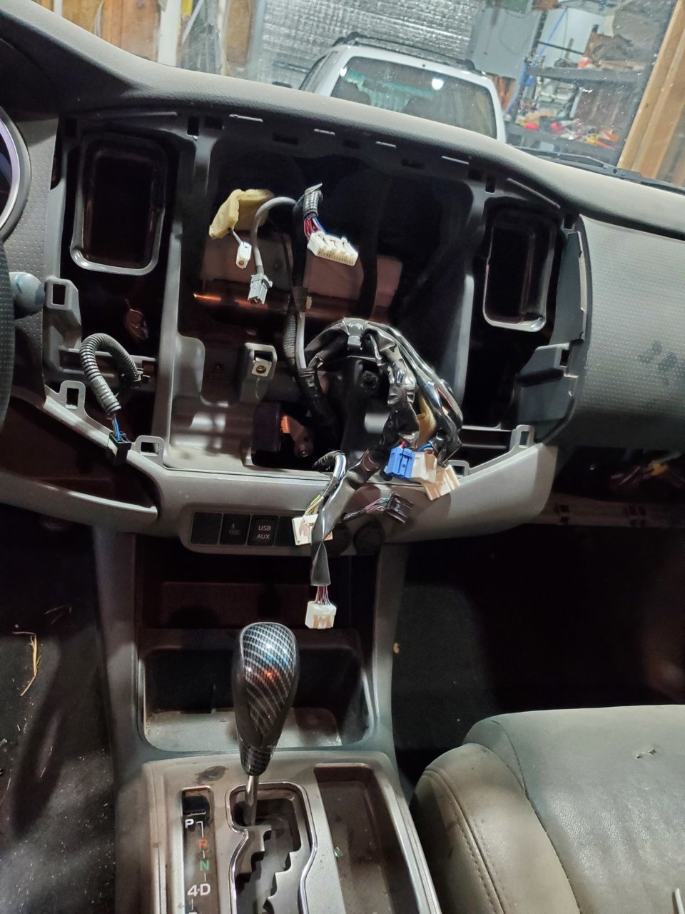

    @Wattapunk I am not sure as we got the truck this way from an auction. The whole dash bezel with vents & switches was taken along with some other stuff, none of those wires cut thankfully. Rear door speakers are intact and factory FWIW.

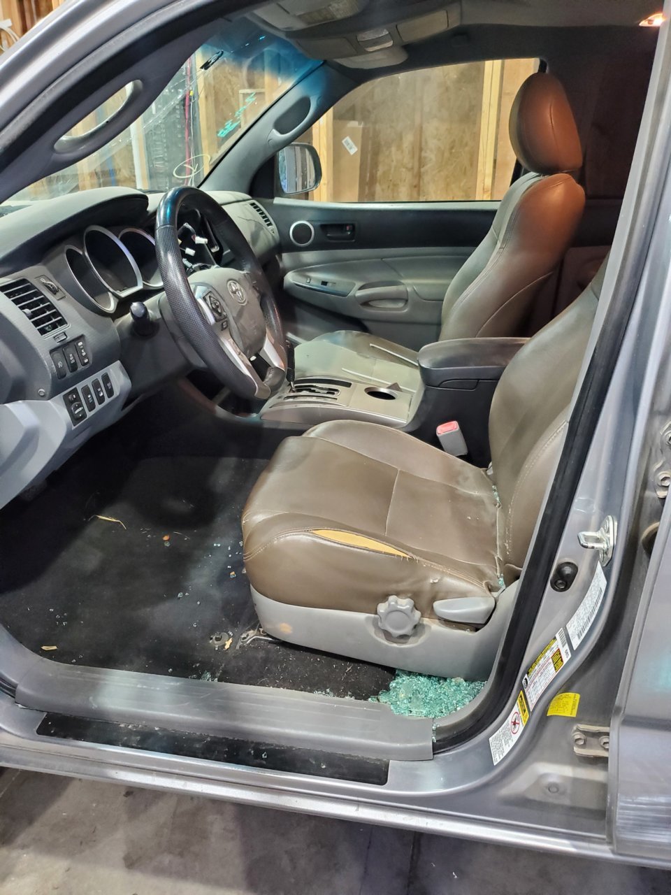

    Like to see some interior pics to see what you are dealing with and welcome to TW.

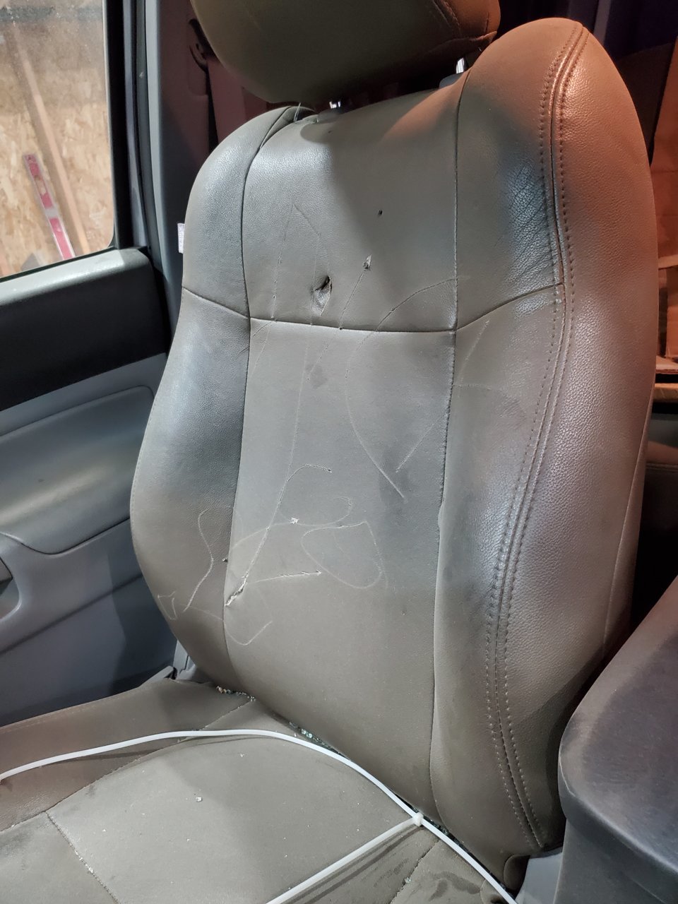

    @Wattapunk here's a couple more I have at the moment. The leather seat sucks, as it's not just a cover over factory fabric like most dealer-installed versions usually are. Still working on what it will cost to fix that.
    @caribe makaira yep that's the bundle going up, the cut in my pic was for that and the speaker going down.
