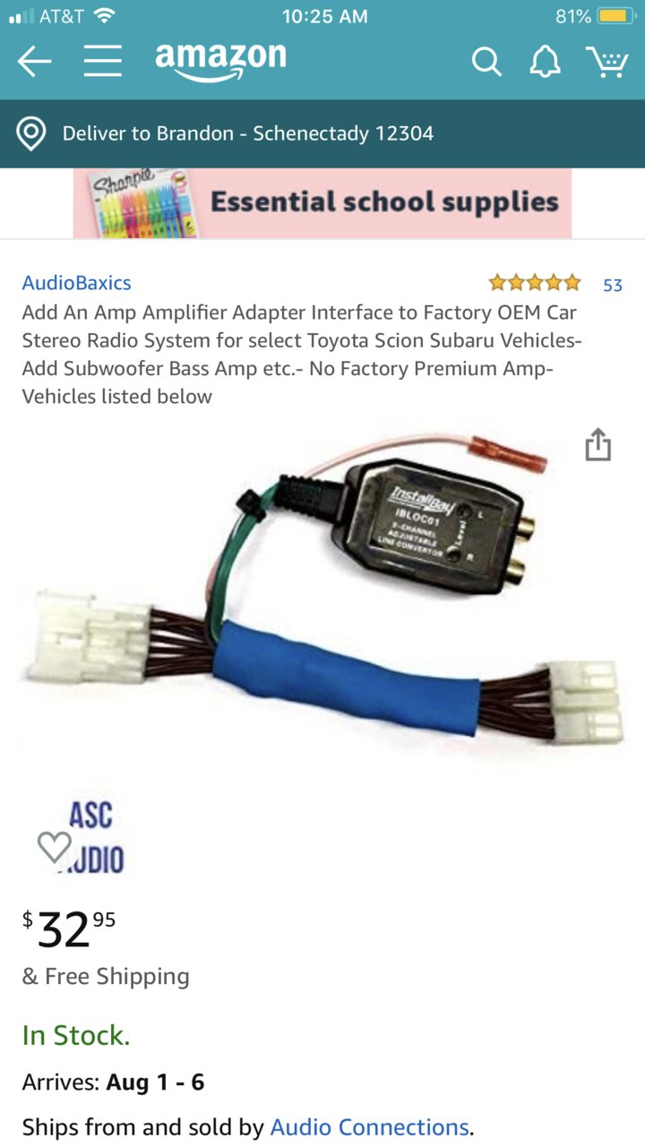

  16. Jul 28, 2019 at 7:25 AM
    #16
    TRD2010SpeedwayBlue
    TRD2010SpeedwayBlue [OP] Well-Known Member
    Sep 12, 2015
    #164039
    1,810
    Brandon
    2010 Speedway Blue TRD Offroad
    this is the harness i was talking about
  17. Jul 29, 2019 at 2:31 PM
    #17
    dolbytone
    dolbytone Well-Known Member
    May 14, 2010
    #37165
    1,317
    South Carolina
    09 TRD Off Road
    That looks like something meant to add a sub amplifier since it has only two channels, unless you only want to amp the front doors.
  18. Jul 29, 2019 at 2:34 PM
    #18
    TRD2010SpeedwayBlue
    Sep 12, 2015
    #164039
    1,810
    Brandon
    ahh. yeah i have no idea just read a while back someone used that but maybe not for speakers only
