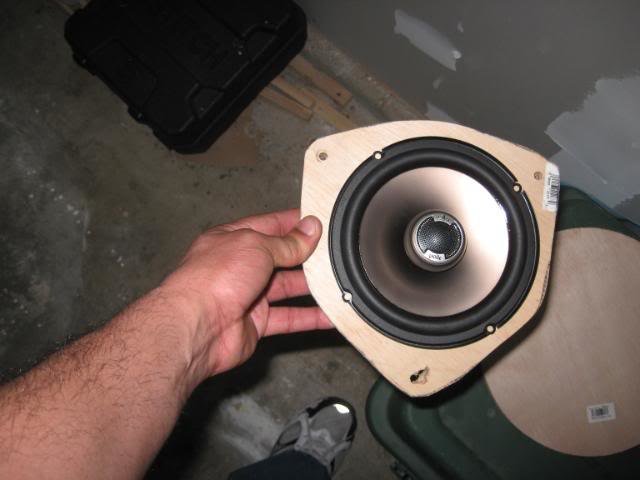

    yup, 6.5"s..
    my front component mid is 6.5" image dynamics ctx65s (components )
    and my rears are polk db651s 6.5"
    under no circumstances should you mount your nice aftermarket speakers without those nice big thick baffle.. that would be a waste, a bad waste..
    If you don't mind a non-sexy appearance, then you can make them.
    For my rears I roughly traced onto thick cardboard the outline
    I made my rears out of some B.S. I found at lowes. eventually i'll re do them.. my fronts I had made and they're nice, my rears are ghetto but effective..
