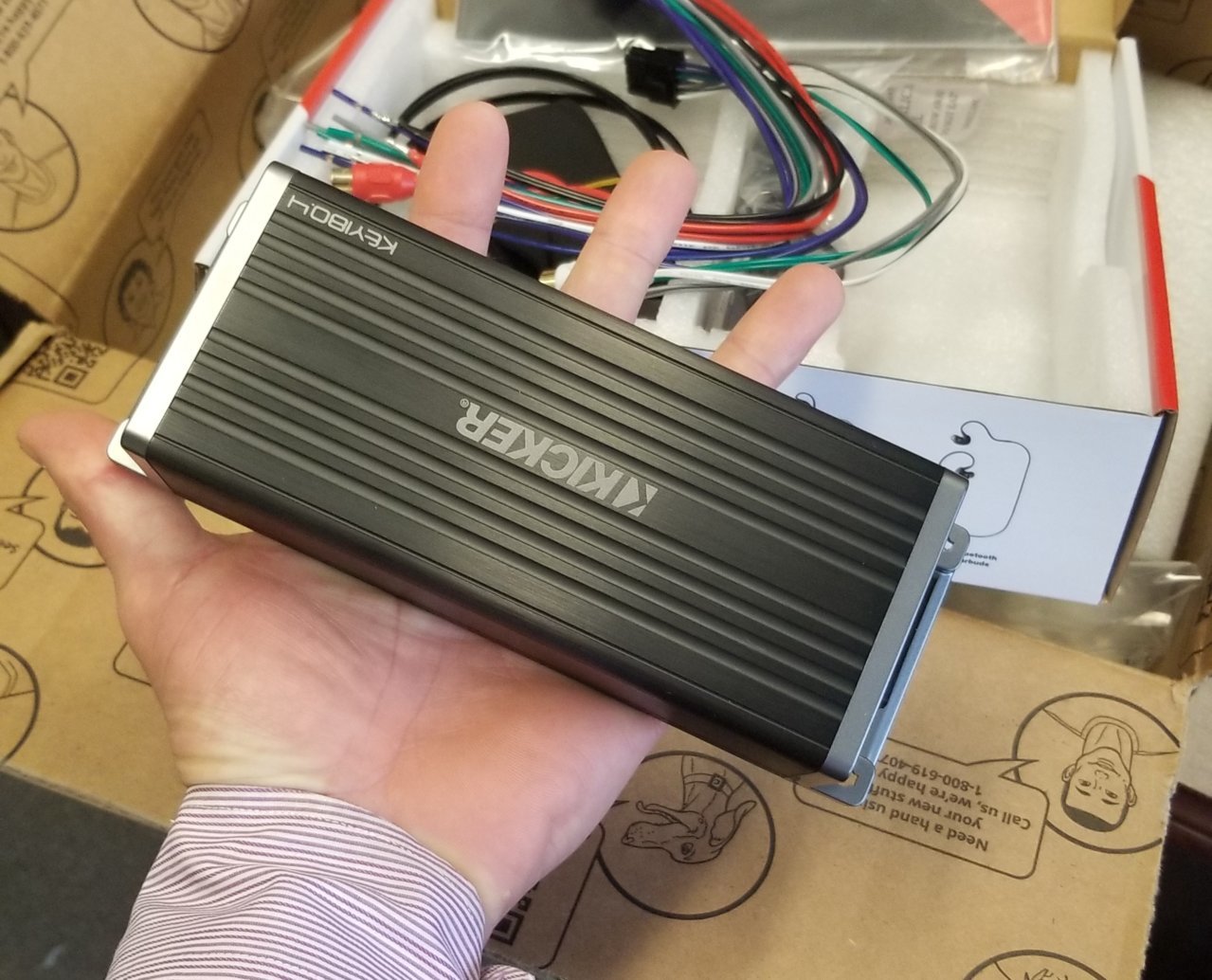

    Plug and Play?
  15. Mar 15, 2020 at 6:49 AM
    RX1cobra
    RX1cobra Well-Known Member
    May 20, 2019
    #293789
    2,186
    19 OR
    Not plug and play but you can buy the plugs and wire it outside the truck. Plugs right into the factory harness after that and no cutting required. It's also powered by the stock wiring so no running power through the firewall.

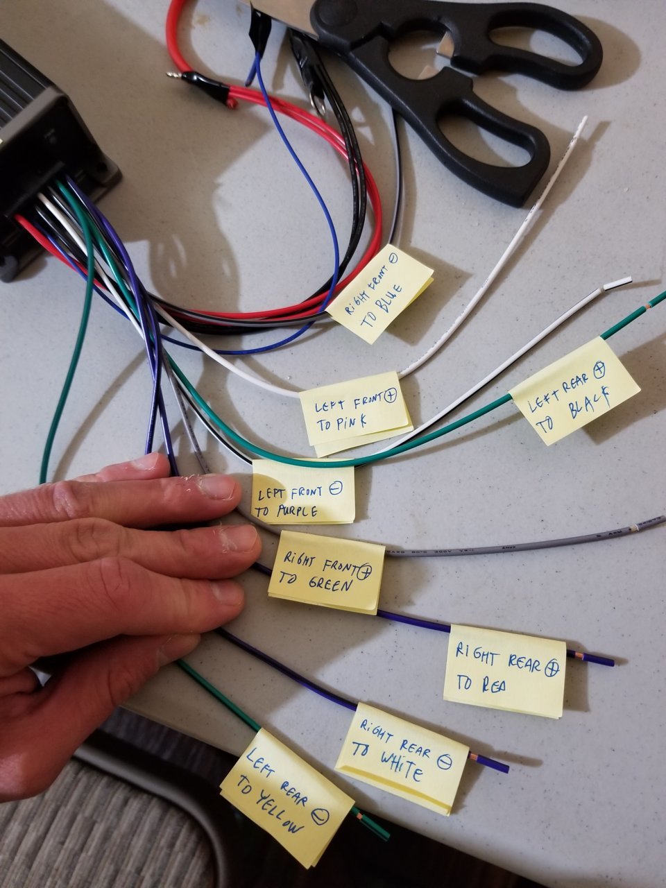

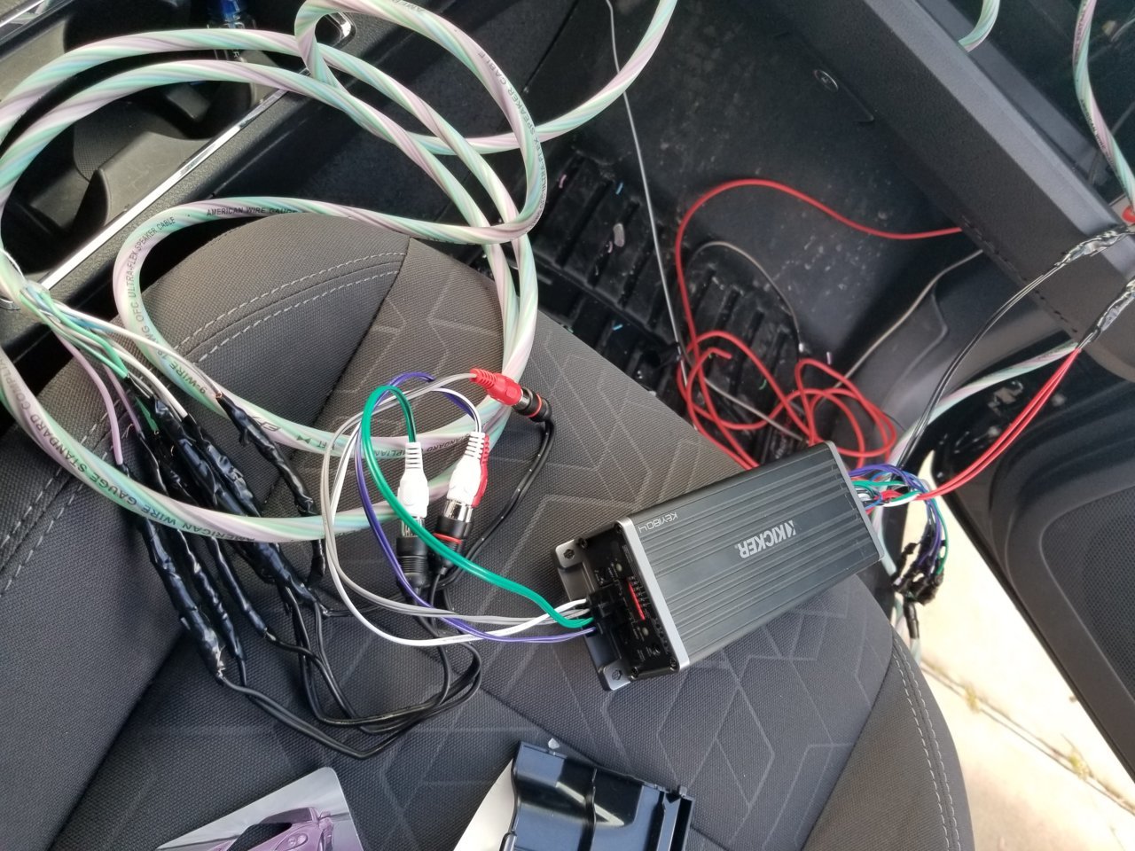

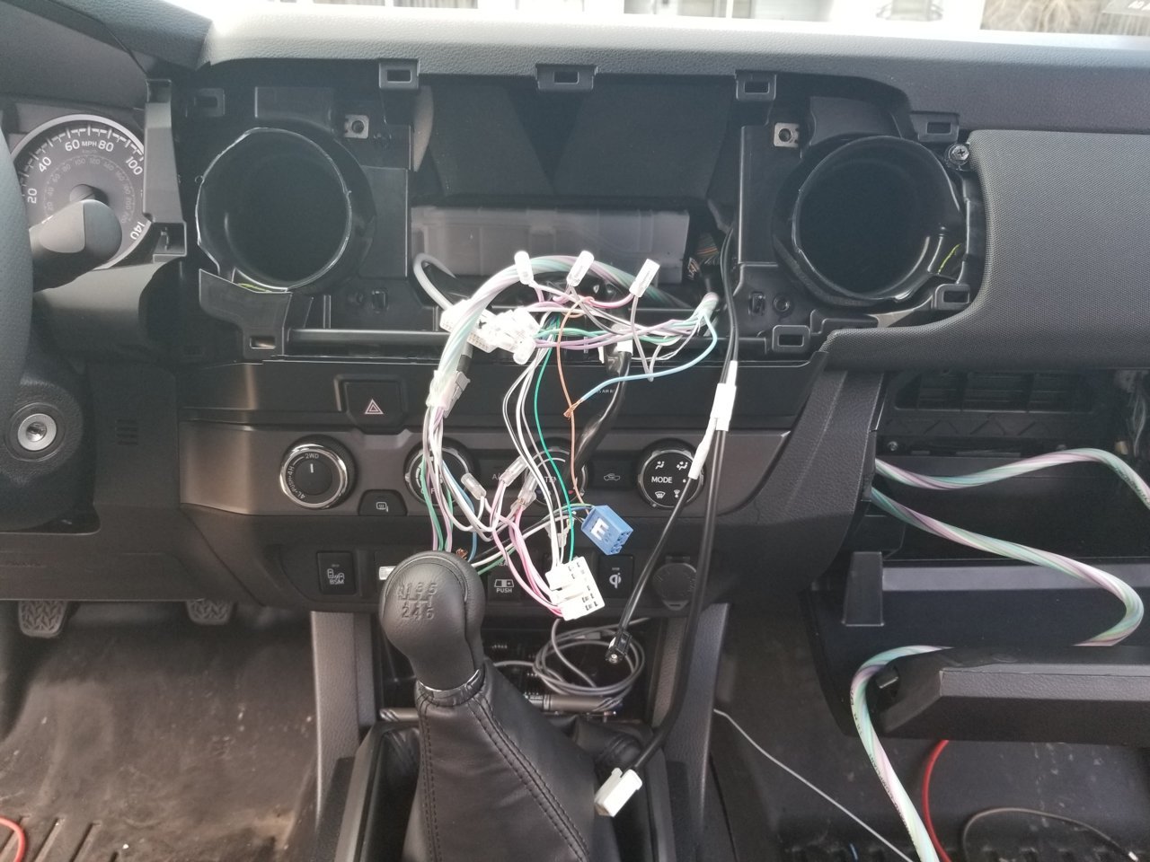

    2019 TRD OR MT
    K & N Intake, Gibson Catback (chopped), Weathertech floormats, 285/70/17 Ridge Grapplers, Black Rhino Glamis wheels, Kicker Key, Kicker Hideaway, Infiniti Speakers, OV Tune, 888's, 5100s X 4, HS 3-leaf, LR SPC UCAs, Diff Drop, Carrier Bearing Drop, OEM Bed Mat, Morimoto HID low beams, Morimoto LED 2 Stroke High Beams, KC 336 LED bar, KC C3 LED pods for rear, KC LED 6'' SlimLites ditch lights, N-Fab Steps, Auxbeam Interior Blue Lights, 7r41lbr34k3r Shift Knob, Wet Okole Seat Covers, Diode Dynamics SAE Pro Fogs, Cali Raised ditch light brackets, hidden light bar brackets, tailgate light brackets.
    Nah. I had to soder to fit with stock head unit. Was easy and fun though.20190216_094236.jpg

    I was a total been and figured it out. Before the amp, I was very disappointed in the volume. Now I have a free badass concert every day!!!
