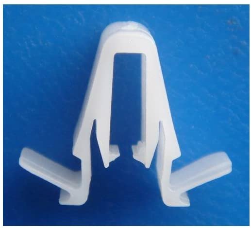

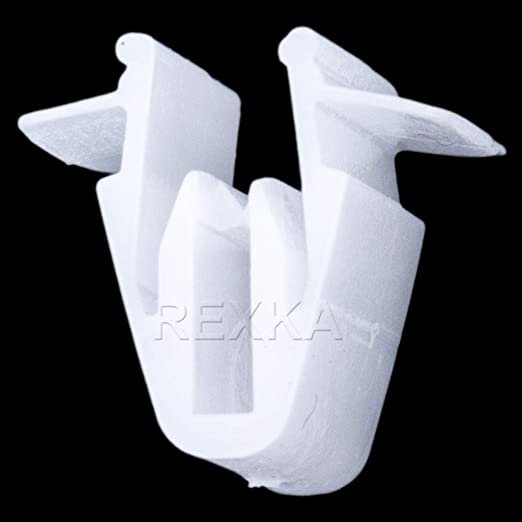

    An important note I learned the hard way: the white plastic v-clips on the A-pillar and B-pillar “garnish” mouldings will be left behind in the door metal, but they must be put back onto the plastic garnish piece before you snap the garnish back into place. If you press the garnish on with the clips still stuck in the door, you’ll push them into the door to be lost. You’ll know what I’m talking about when you take your door apart.

    I need a couple of these, anyone got some for cheap? I've only seen 30 packs

    I pushed one in and it went into the inside of the door. I did not want to go fishing for it as it would be in fluid film (rust protection). Asked the local Toyota dealer how much for just 1 white clip? Toyota Part Number: 67771-58010
    $9.50 each plus tax (Canadian $) and they need to be ordered. I said I can live without one for now. If I get time to remove the rear door panel and plastic sheet maybe I can fish through the fluid film for the small white clip. I hope I didn't bust it when I pressed the trim piece back on.

    Yeah stealership or $6.99 tax included, with free shipping for 30 pieces....search Amazon 67771-58010
    Ordered, should be here by the end of May 2020, anyone need some? I'll mail you some if you PM me.
