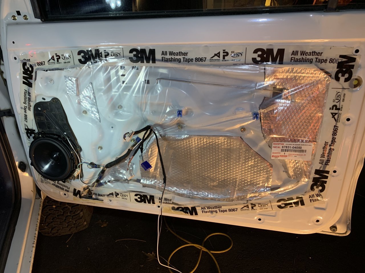

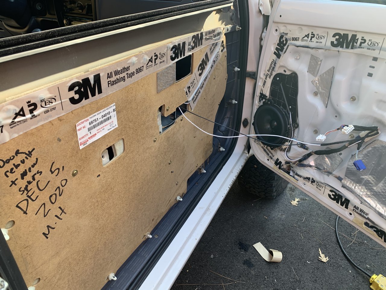

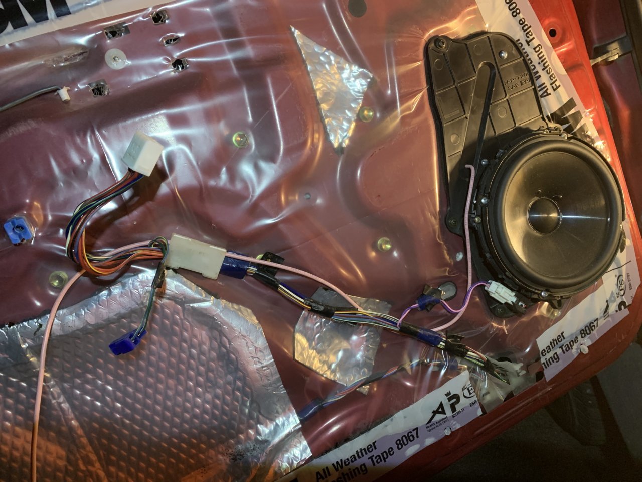

    I just did these in both my 99's. I added a ton of Noico sound deadening material (3 boxes for 2 trucks) to the door panels (like 3-4 layers on the sheet metal) and also on the inside panel. Also bought new OEM plastic weather liners, lubed all the window components, lubed all the lock/latch components, new interior weather stripping. Buy the eBay door panel clips as you will break a bunch.
    Bass is decent, clarity is 1000 times better. Fit is pretty easy with the included brackets. Road noise went way down too.
    Front: https://www.crutchfield.com/p_108R6530CM/Infinity-Reference-REF-6530cx.html?omnews=10537337
    Rear: https://www.crutchfield.com/p_108R6532EM/Infinity-Reference-REF-6532ex.html?omnews=10537337

    Would your crossovers not fit with the covers on?? Thats a great idea to mount them on the back . Are you worried about them getting wet?

    Correct, they didn't quite fit with the covers, and I took off the covers and realized they didn't really provide any weather protection anyways. I did the red truck about a year ago, but the picture is from last week (I forgot how I did them and wanted to duplicate my methods on the white truck haha), and if you look carefully you can see the terminal screws getting a little rusty. So I ended up coating the entire crossover in the spray-on liquid electrical tape. I sprayed it on after the wires were connected, etc so that it covered the terminals and everything. Several light coats is key. Also the crossovers have double-side tape between them and the plastic speaker plates to avoid rattling, and are secured by two screws/nut with thread locker.
    chrslefty[QUOTED] and ireymon like this.

    That "crossover", that you mounted on the back of the black plastic piece that the speaker is attached to, did you order that with the speakers...?

    There are several linkages in that area. I replaced the white clip that holds the horizontal pull rod from the interior door handle as it always seem brittle, and the rod is very long so prime candidate for rattling. The window tracks also get lose, so tighten all of their mounting bolts while you have the door apart (some are visible in the jamb without disassembly so start there). Could also be the lock/unlock plung as it is rod inside a plastic sleeve (slim jim prevention I think). Lastly evaluate your gears/linkage for the powoer windows. The rivets, etc can get wallowed out to the point where they are rattling. I greased the gear and all the tracks/rollers with a clear grease and it helps with noise while running the window.
    Yes I chose what they call a "component" system where the tweeter is mounted in a different spot than the woofer. It helps with stereo positioning as our speakers are very low so your leg covers them which muffles higher frequencies. It also means you get a real crossover (instead of just a capacitor as you would with a 2-way all in one speaker). The tweeter is mounted on the door panel up above the arm rest (I don't have a pic handy but I can take one if you'd like). I think this make a better speaker system and there was a sale both times that I bought them so it wasn't much of a price difference. The labor is a bit higher though! That crossover has an input from your stereo or amp, and then an output for the tweeter, and one for the woofer. Check out my Crutchfield links in my post above as they have great photos of what you are getting.
    If all of this is too much and you just want an all in one, my link for the "rear" speakers will work in the front just fine, and if you end up not liking them you can put them in the rear and get a component system in the front. The rear speakers on these trucks are in a sort of enclosure that actually has a decent bass enhancement so don't forget about them back there.
