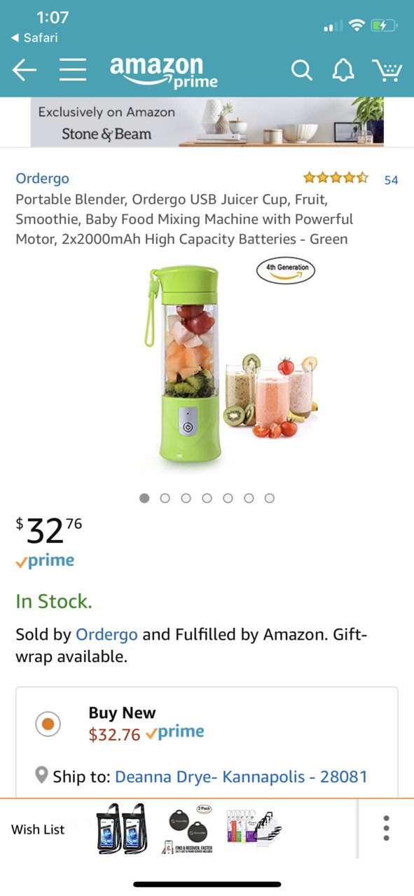

    What about a portable blender?
    2016trdtacoma and Spare Parts like this.
