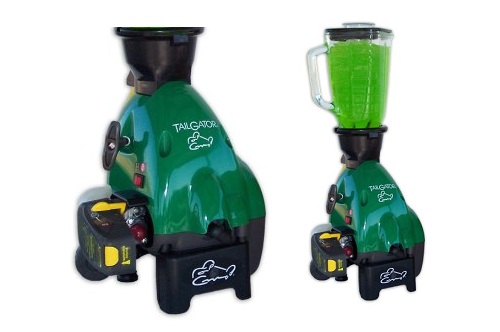

    Wow. So many awesome responses. Thank you all! I just got an email back from vitamix. They say I’ll need 2700watts.:ohsnap: So I am thinking the inverter is a no go for sure.
    Love the gas powered blender! I had no idea that was a thing. I could make one hellofa margarita for the wife while I am at it.
