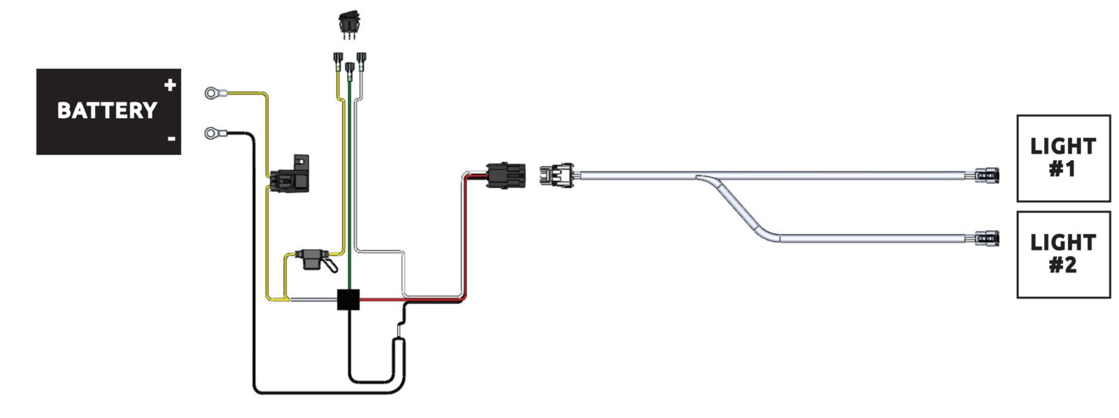

    Was looking at the rigid 360 for my arb bumper but I'd much rather have an amber/white light instead! Question is, how do you switch the lights? 3 position switch? Or could I wire it to a switch pro panel?

    It comes with a 3 position switch...you can wire it to the switch pro if you two slots available. And then you can fuse it based on the wiring diagram I'm attaching....image (1).png

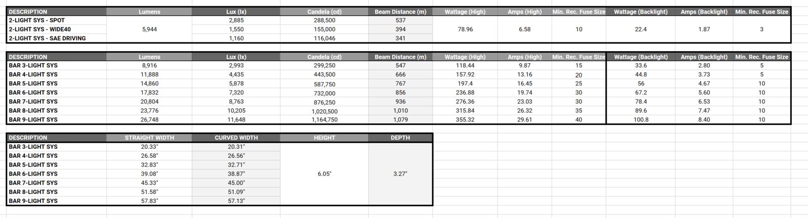

    I'm assuming because you mentioned your bumper, that you were looking at the pair pack. The wiring would be essentially the same, with different end/light (pair pack vs. bar). I'm also attaching the comparative specs / output in case you're looking for that info as well. Also, at the bottom, there's a YouTube link that explains 3 possible scenarios for lighting to switches (s-pods or the like). Hopefully that helps!
