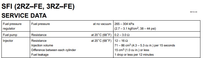

    What is the flow rate of stock injectors and the stock fuel pump on a 5spd 2003 2rzfe?

    Not sure if this helps:
    There are some additional service specifications in other sections of the FSM, so it might be best if you find a digital copy for yourself and take a look.
