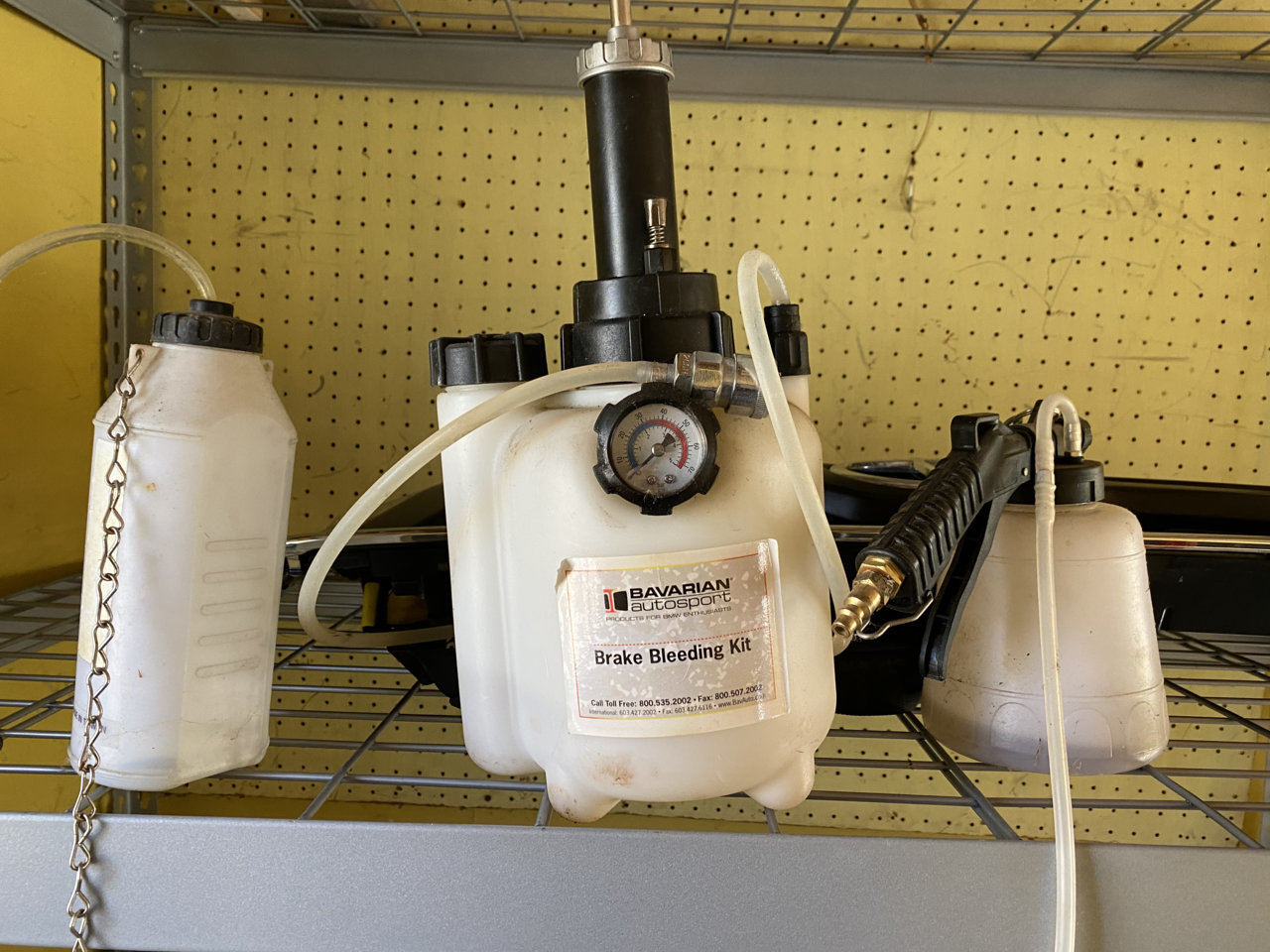

    I have used a Motive for years mostly on Euro/vintage cars. I only used it to apply a pressure source, so I don't fill any fluid into the container. I just monitor the reservoir to keep it full and try to keep a constant but low pressure in the tank. It is way less messy and more controlled use of the Motive to me. I do need to get the adapter Crow Horse mentioned for the Toyota as the Motive chain one seems a bit iffy.
