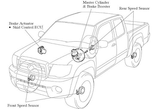

    I believe there's one in each wheel hub.

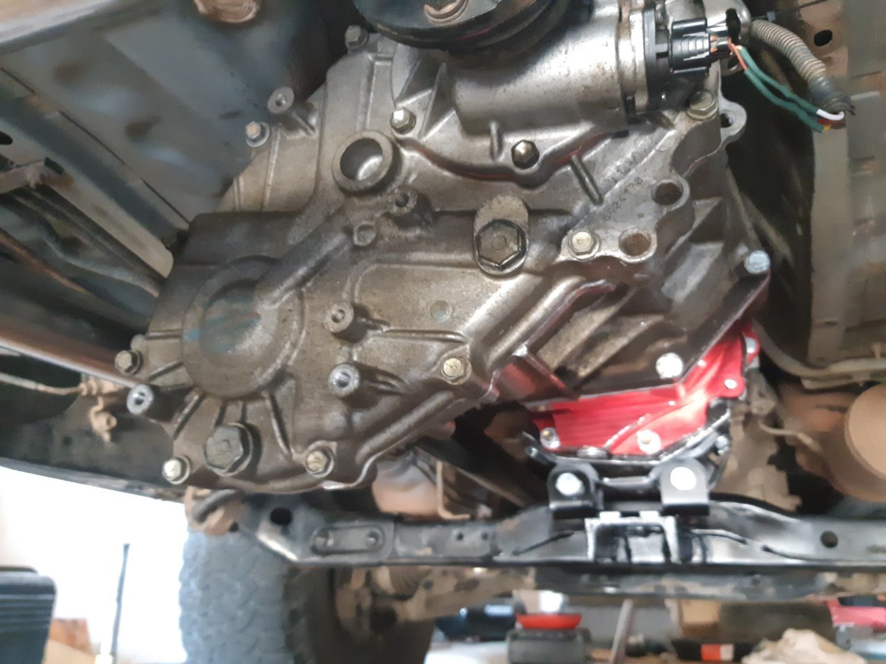

    Its either in the wheel like @replica9000 said or some 2nd gens had it on the back of the transfer case, under the output shaft. If you have a flat cover instead of a wire sticking out like shown, it's in the wheels.

    The one for the speedometer on a manual transmission should be on the tail housing of the transmission for a 2wd or on the output shaft of the transfer case for a 4wd.
    If your referring to speed sensors for the ABS theres one at each wheel.
