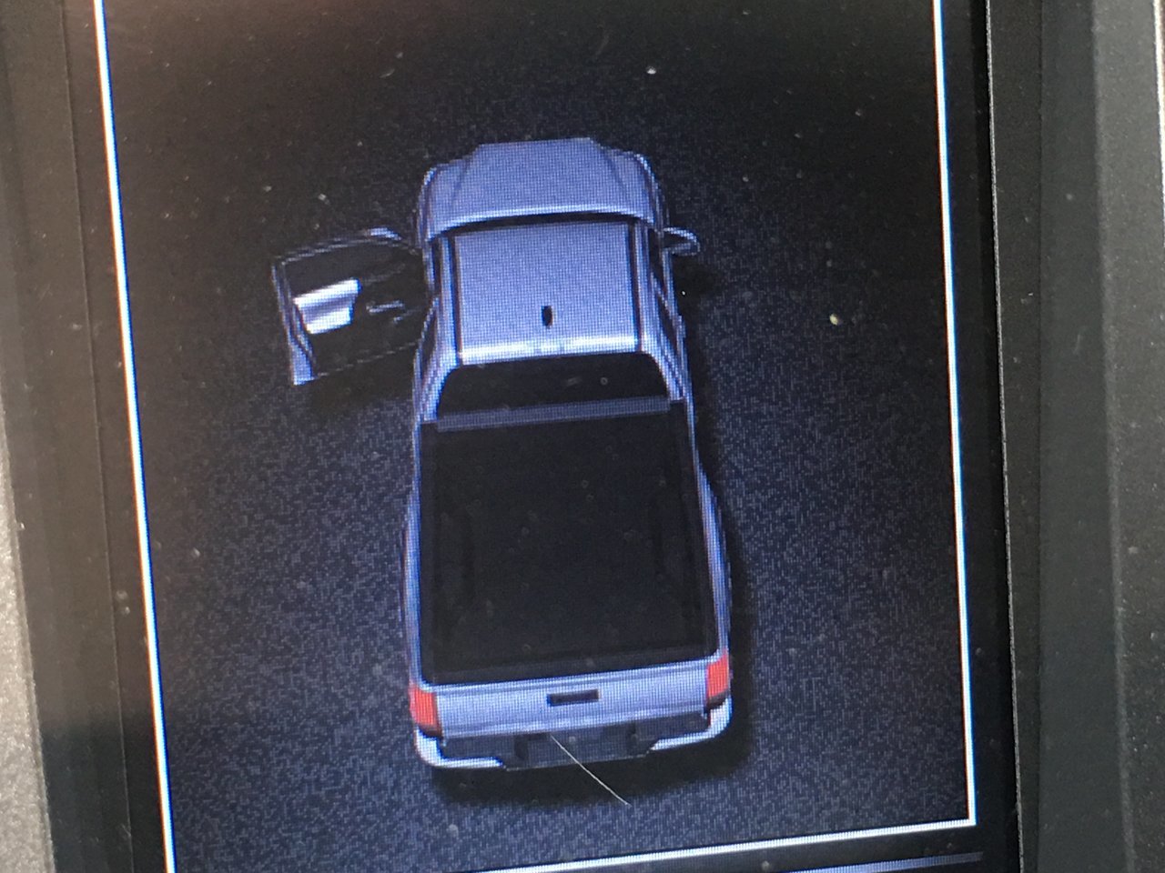

    Wasn't sure where to post this. I can't tell if this is a hair/fiber, or an actual scratch on the screen. Sometimes it's visible, other times it's not. (Just under the tailgate in the graphic)IMG_8878.jpg
  8. Jul 27, 2017 at 9:46 PM
    #88
    shakerhood
    shakerhood Well-Known Member
    Aug 9, 2015
    #161370
    36,973
    Southern Ohio
    2017 MGM DCSB Off Road, 6 Speed MT, P&T
    Looks like a scratch
    joepagejr likes this.
