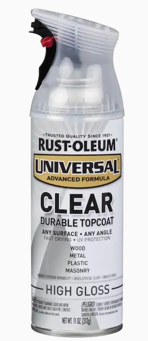

    My buddy had a lot of scratches on his cluster plastic, so he removed it to buff the scratches off and apply a clear coat of rustoleum topcoat and problem solved. 4 years after and his plastic cluster looks BRAND NEW!!!
    tonered likes this.

    Now that is some good info. 3rd Gen and no discoloration? Just curious in case the material type is different.
    Even being as gentle as possible and clearing the loose stuff off with a Swiffer Duster, I'm starting to get some fine scratches.
