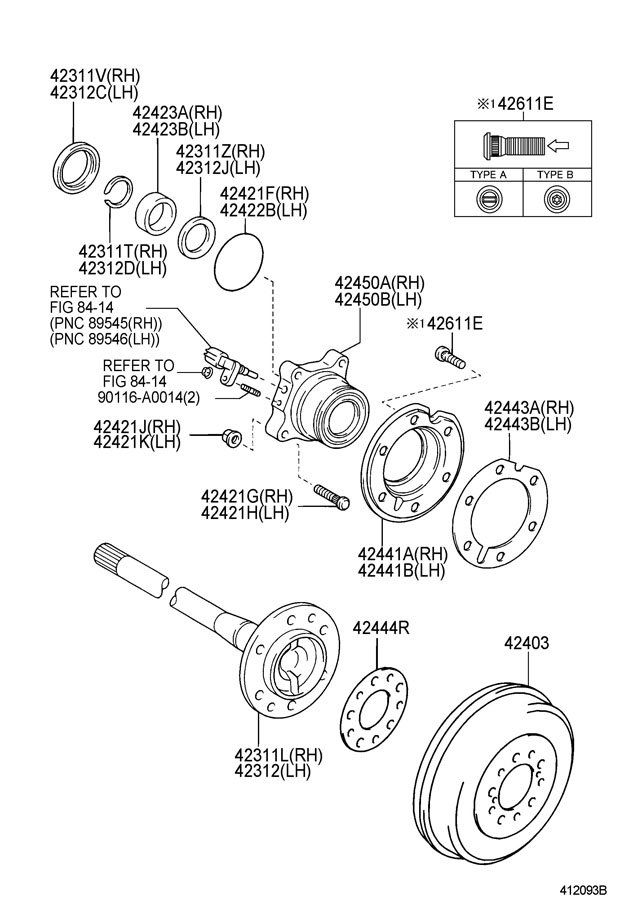

    The ABS reluctor ring (Toyota calls it Skid Control Rotor) is right there on the axle in the hub where the ABS sensor goes.
    The tire size has nothing to do with the speedometer system, other than the larger outer diameter makes fewer revolutions per mile thus it decreases RPMs for the same distance traveled thus being reflected in speed.
    So...
    No.

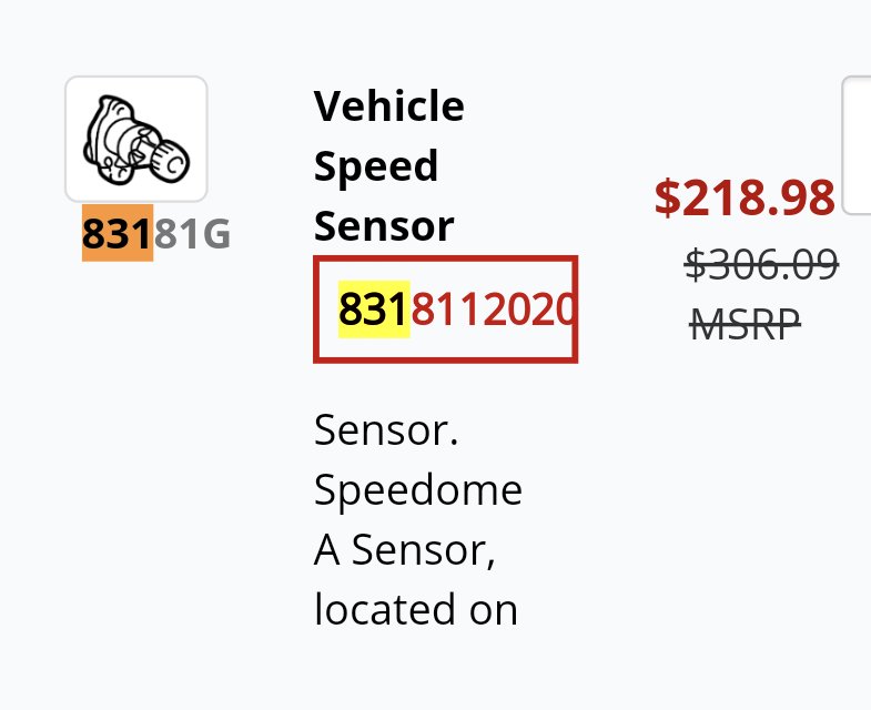

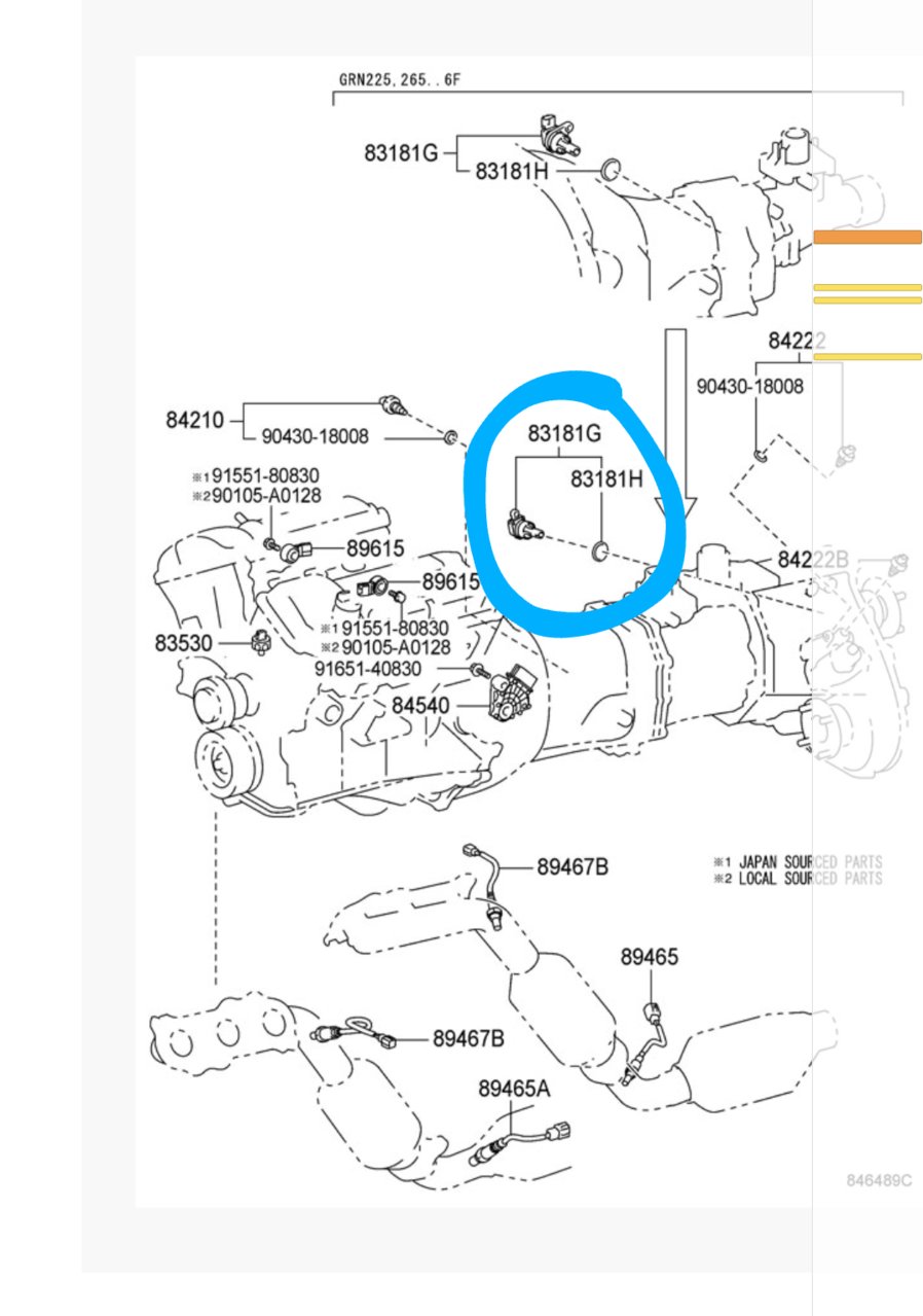

    Besides, the speed sensor is read off the transmission anyways.
    :jerkoff:

    I don't know how to explain this so it clicks for you but I will try.
    In my truck, my speedometer is read at the transfer case output. So for ME, changing gears impacts my speedo. This is because now my driveshaft is spinning faster to travel at the same speed. I know this from first-hand experience. I would be driving around town and my truck thought I was going 70mph when in reality I was going like 45.
    For most other tacomas, it's read at the ABS sensor, meaning tire rotations. Going 70 mph with 3.73 gears and 70 mph with 4.88 gears, the tires will be rotating the same amount. Thus, your speedo will read the same. The reason tire OD impacts the speedo is because you're now traveling further per RPM. Hence why people with larger tires will have a speedo off by ~5%-10% depending on what size they go with.

    I think the reason you're confused here is because you're likely in the same boat as me. The earlier manual transmissions are read at the t case output, in which case yes, gears impact speedo.
    Tacoma’20 likes this.
