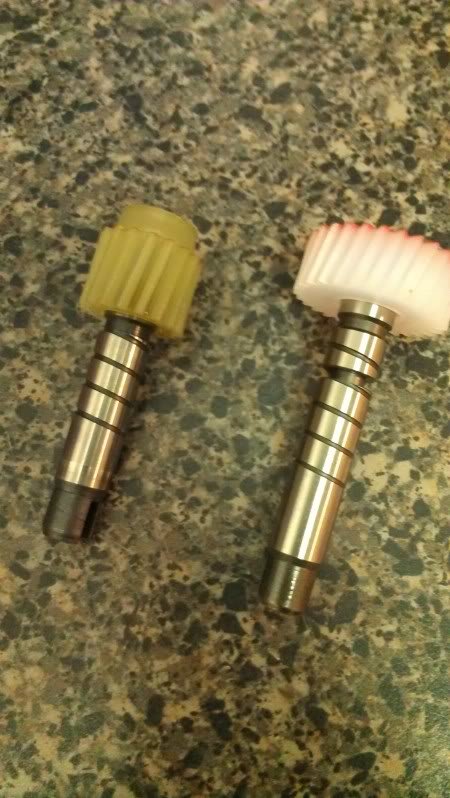

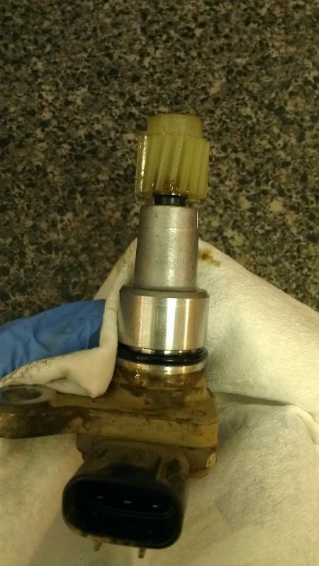

    So I saw a thread on TTora about swapping the trans speedometer gear to fix incorrect readings. The FAQ said that my stock gear was most likely a 30 tooth gear and that I should install a 28 tooth to compensate.
    Well I removed my gear and it was totally different than the new one. It only had 17 teeth and I'm a little confused. Has anyone had any experience with this? Any insight would be greatly appreciated.
    Here is a link to the original thread.
    http://ttora.com/wiki/index.php/Speedometer_error
    And pics to show the difference:
    http://www.norcalttora.com/~chris/misc/speedo drive gear/photos/photo_4.html

    If anyone cares this mod was done on a 4x4 so I am assuming it will not work for prerunners :(
