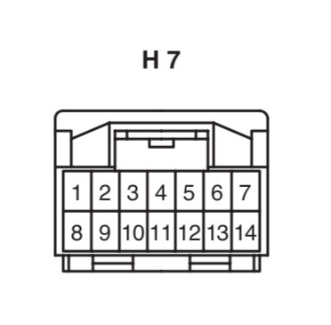

    Looking at wiring diagrams I can't see how it's all related but since you say it all quit at once I'd say start with checking powers and grounds at something relatively simple like the clock or turn signal flasher.
    I can't find a pinout for the clock but you should be able to go by wire colors.

    Pins 7, 11, 13, and 14 for the clock

    I’m not the best with wiring diagrams but I’ll try and figure it out. The clock only died for a couple hours and is working fine again.
