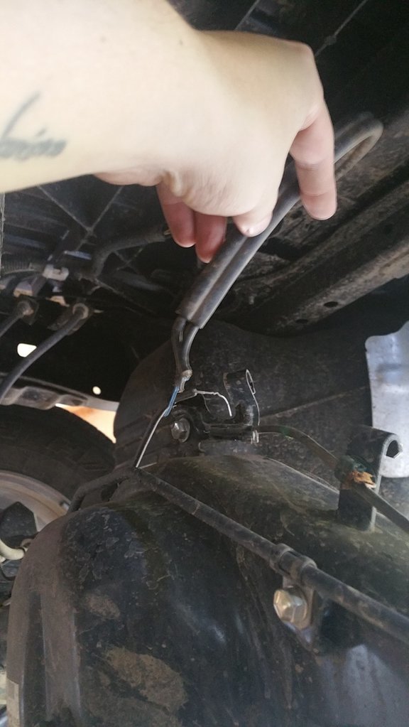

    Was out on FS roads, power line roads, and other such places today. No mud, no high centering, no significant branches run over... Was in 4wd a lot. No high speeds. Some steep stuff, some flexing. I'm fairly certain this has to do with a speed sensor or the wiring for it, but I don't see anything obvious.
    Any ideas?

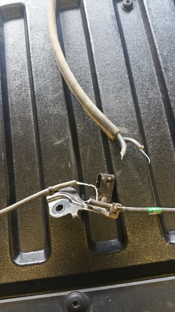

    Well, they quoted me $475 to fix this...
    Fortunately, I'm smart enough to use a butt splice.

    Might be shielded wire. If so, butt splice will be a problem...

    It wasn't.
