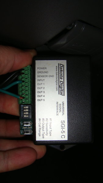

    The speedo in my '03 was off when I had 265-75-16's. I installed this Dakota Digital item which corrected it. When I went to a larger tire, I simply made the setting adjustments with it. I did the same when I re-geared.
    Check out their site to see if this will work for your truck.
