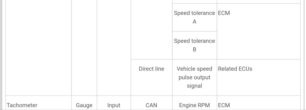

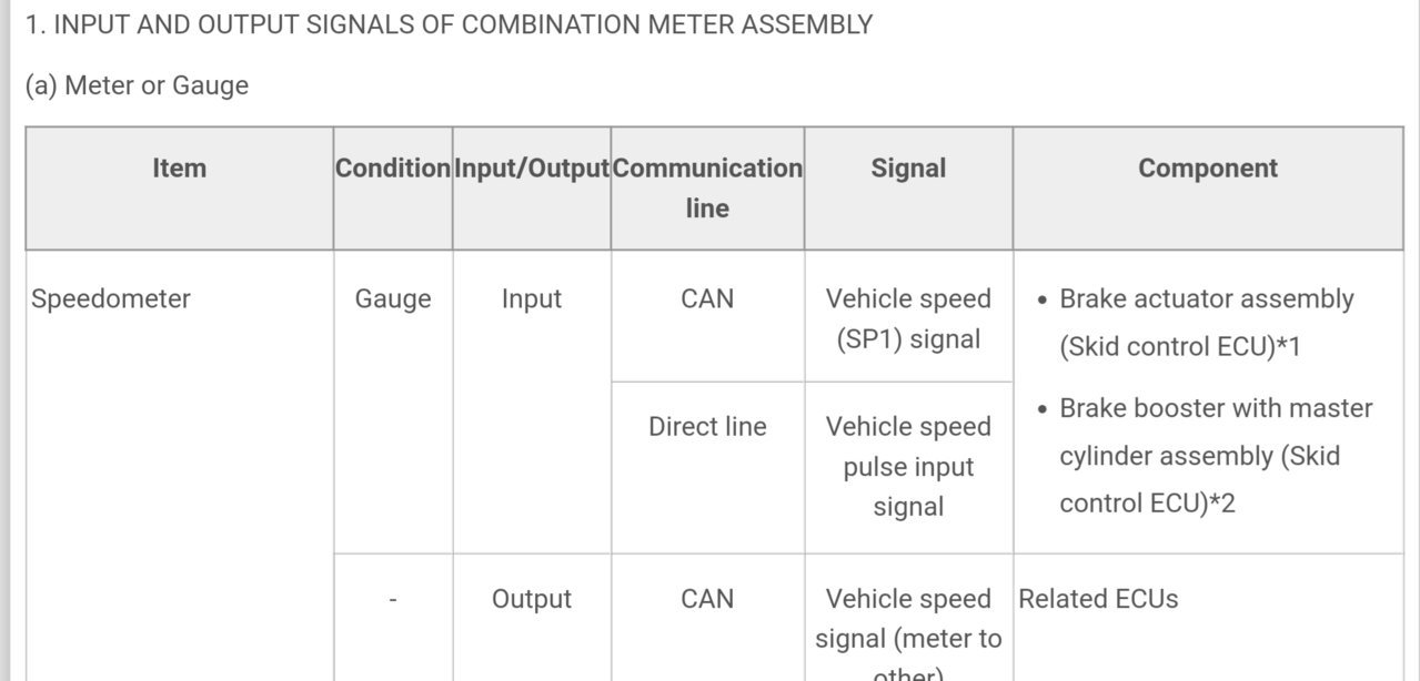

  14. Oct 26, 2020 at 4:14 PM
    ShimStack
    ShimStack Well-Known Member
    Mar 11, 2012
    #74701
    1,647
    Ben
    NC
    '91 Truggy, '98 Project, '16 DC OR M/T Locked F/R
    It isn't. The cluster (combination meter) receives a CAN message that indicates vehicle speed. I'll have to double check but 99% sure the skid control ecu puts this message on the bus.
    Boghog1[QUOTED] likes this.
  15. Oct 26, 2020 at 4:25 PM
    ShimStack
    Mar 11, 2012
    #74701
    1,647
    Ben
    NC
    @Boghog1
    Ok so the meter gets both a CAN message and direct pulse line from the skid control ECU. I do not know how it uses this info. It then outputs both a direct pulse line and CAN message to other ECU's. So there's a lot of vehicle speed information flying around.
    Boghog1 likes this.
