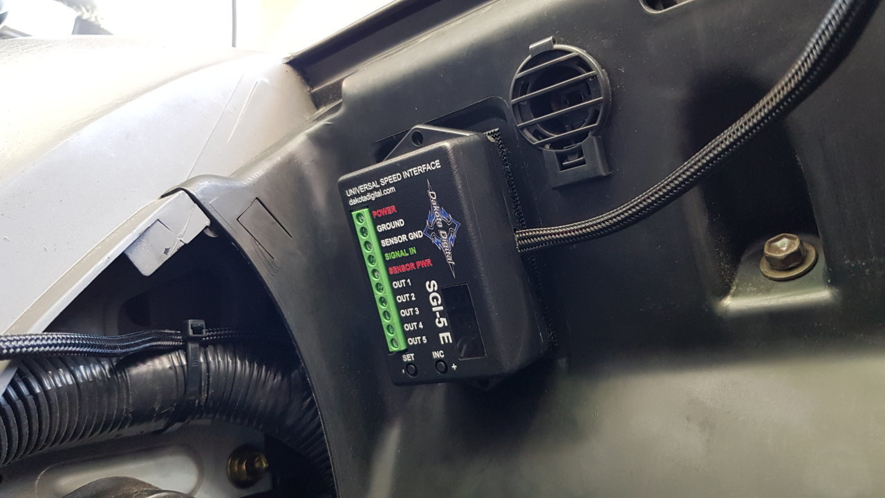

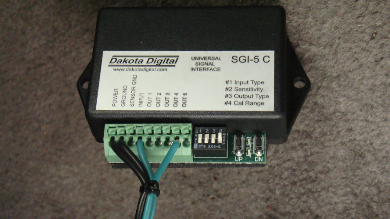

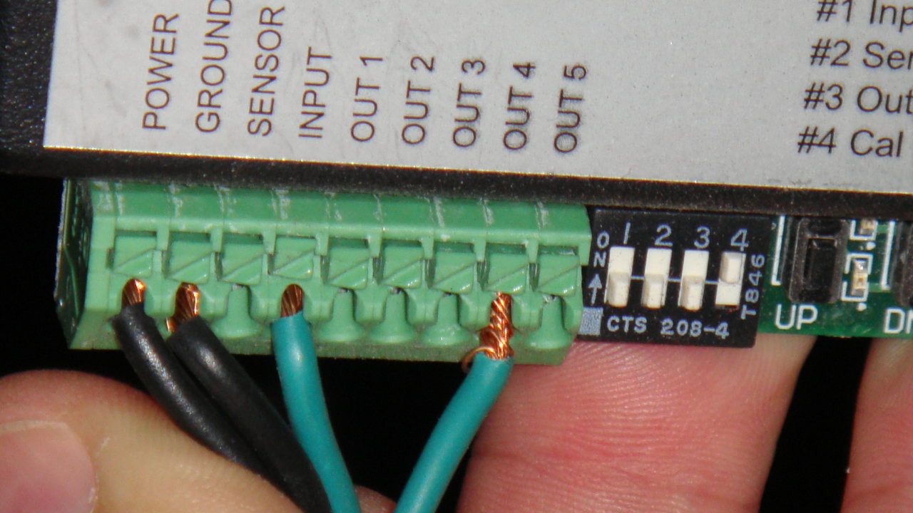

    I don't have a 2nd gen but yes it will correct the odometer if it gets it signal off the speedo sensor. Well that is how accurately you can calibrate the Dakota Digital.
    ABS & cruise control should work fine also. All it does it alter the pulse signal of the speed sensor. I don't have ABS but my cruise control works perfectly fine. Been running mine (5E) for about 4 years now with no issues.
    https://www.tacomaworld.com/threads/my-dakota-digital-sgi-5e-install-speedometer-calibration.560236/
