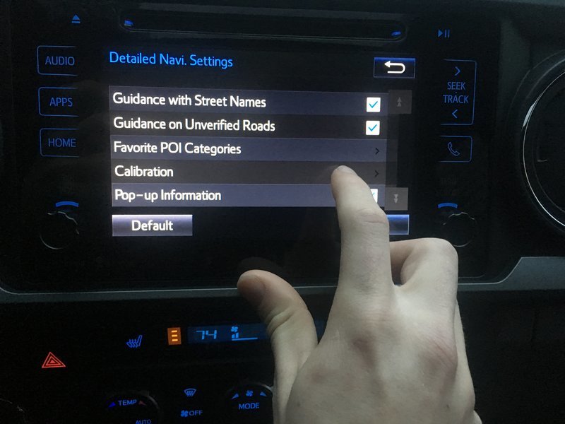

    I saw this in the trucks menu for recalibration when you get new tires. I run stock, but maybe someone can verify if this actually works. Looks like it uses the GPS.
    Setup>Navigation>Detailed Nav Settings>Calibration>Tire Change
    TRD OR BUST!, Hank Heel and Pax11B like this.

    Holy crap! If that really works..these trucks continue to surprise me

    I believe that the calibration through Entune is just to adjust the gps location somewhat and Not calibrate speedometer for taller tires.
    Edit: Actually it adjusts the compass
