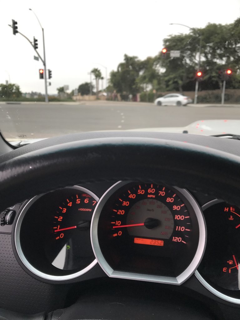

    Here's a pic of the truck the other day at a red light. Speedometer reads 7mph stopped at a redlight. That morning the speedometer was deadnuts accurate to the GPS, on the way home it was all over the place.

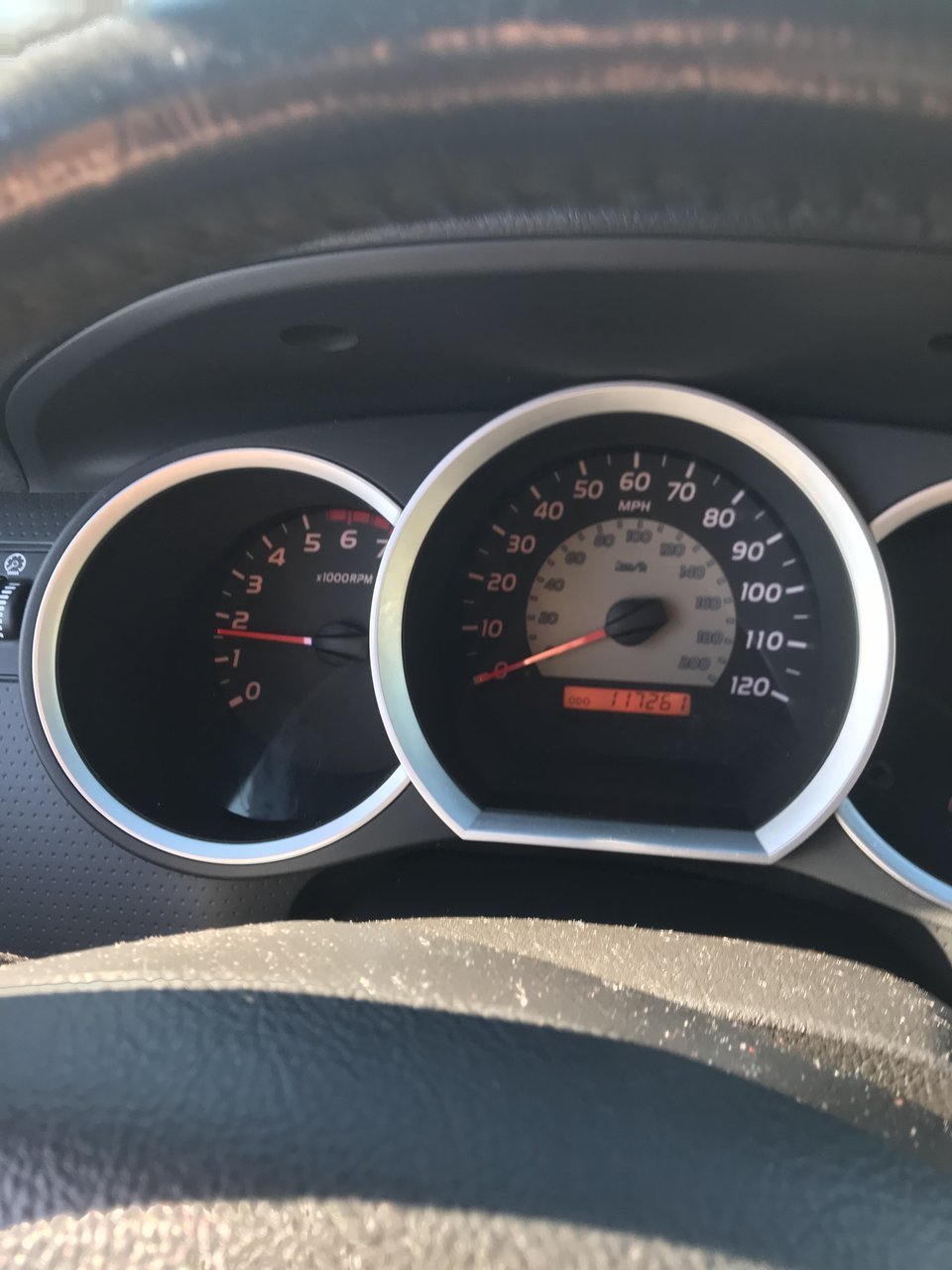

    Didn’t work at all on my way home from Work now. Odometer works though, and I got gas!
